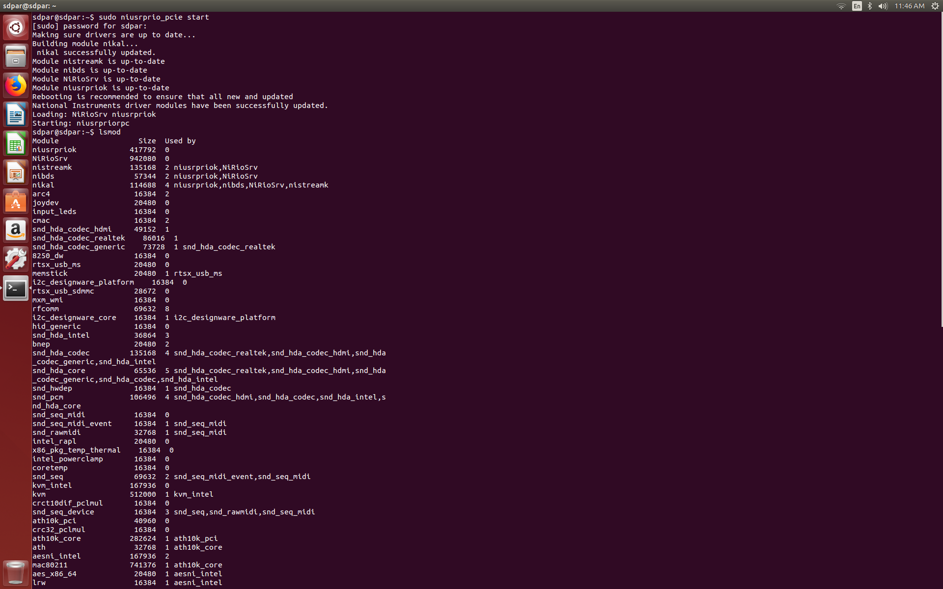

I was not able to find x310 with uhd_find_devices, and the "lspci -k -d
1093:c4c4" result does not have kernel driver or kernel module information.

Does "lsmod" show the driver modules loaded?

关钧丰
Tue, Jul 2, 2019 3:47 PM
Yes, its loaded, this is the lsmod result:
[image: Screenshot from 2019-07-02 11:46:14.png]

Yes, its loaded, this is the lsmod result: [image: Screenshot from 2019-07-02 11:46:14.png] On Tue, Jul 2, 2019 at 11:46 AM Marcus D. Leech via USRP-users < usrp-users@lists.ettus.com> wrote: > On 07/02/2019 11:32 AM, 关钧丰 via USRP-users wrote: > > Hi, > > > > I'm wondering if anyone has successful experience with PCIe > > connectivity with x310 USRP on a Ubuntu desktop via the NI PCIe-8371 > card. > > I was not able to find x310 with uhd_find_devices, and the "lspci -k > > -d 1093:c4c4" result does not have kernel driver or kernel module > > information. > > I noticed the ettus website says niusrprio only supports linux kernel > > driver 4.2, and I tried Ubuntu 14.04.2 but it did not work as Ubuntu > > 16 and 18. > > > > However, I did got it to work on a Ubuntu 16 laptop with the NI > > ExpressCard-8360 Host Card. > > > > I really appreciate your help and concern. BTW, its my first time post > > to this mailing list, please let me know if I did anything wrong. > > > > Best regards, > > Jayden > > > Also, did you use the installer shown here: > > https://files.ettus.com/manual/page_ni_rio_kernel.html#linux_rio > > > > _______________________________________________ > USRP-users mailing list > USRP-users@lists.ettus.com > http://lists.ettus.com/mailman/listinfo/usrp-users_lists.ettus.com >
     OK, so next thing to check.   Was the X310 *powered up* when
     you booted the system?
OK, so next thing to check.  Was the X310 powered up when you booted
the system?
