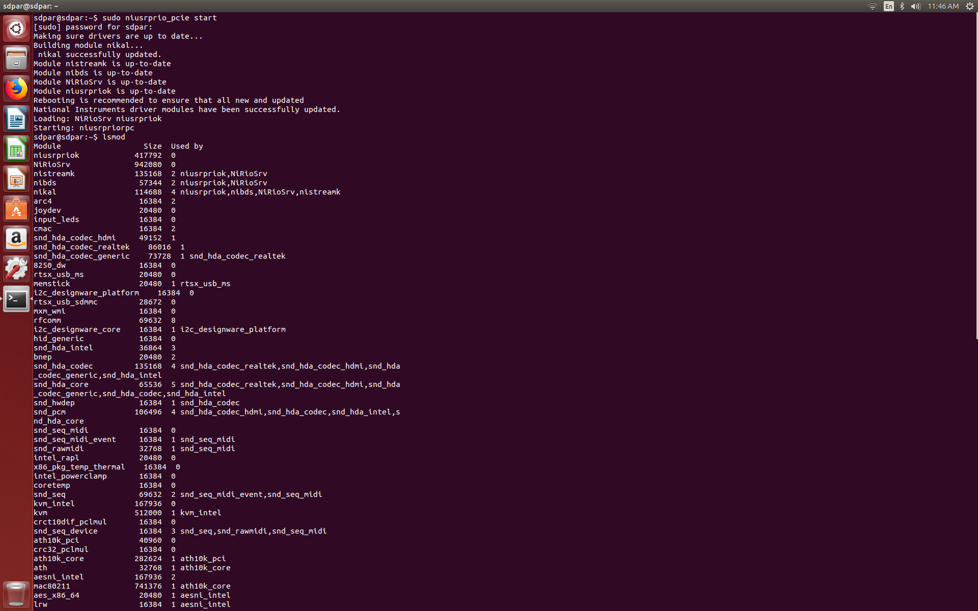

         On 07/02/2019 11:47 AM, 关钧丰 wrote:
         Yes, its loaded, this is the lsmod result:
         Screenshot from 2019-07-02 11:46:14.png
         OK, so next thing to check.   Was the X310 *powered up*
         when you booted the system?

             On 07/02/2019 11:32 AM, 关钧丰 via USRP-users wrote:
Hi,
I'm wondering if anyone has successful experience
             with PCIe
connectivity with x310 USRP on a Ubuntu desktop
             via the NI PCIe-8371 card.
I was not able to find x310 with
             uhd_find_devices, and the "lspci -k
-d 1093:c4c4" result does not have kernel driver
             or kernel module
information.
I noticed the ettus website says niusrprio only
             supports linux kernel
driver 4.2, and I tried Ubuntu 14.04.2 but it did
             not work as Ubuntu
16 and 18.
However, I did got it to work on a Ubuntu 16
             laptop with the NI
ExpressCard-8360 Host Card.
I really appreciate your help and concern. BTW,
             its my first time post
to this mailing list, please let me know if I did
             anything wrong.
Best regards,
Jayden
                 wrote:
Hi,
                 experience with PCIe
                 desktop via the NI PCIe-8371 card.
                 driver or kernel module
information.
                 only supports linux kernel
                 it did not work as Ubuntu
16 and 18.
                 laptop with the NI
                 BTW, its my first time post
                 I did anything wrong.
Best regards,
Jayden
[Screenshot from                                            2019-07-02 11:46:14.png]
OK, so next thing to check.  Was the X310 powered up when you booted the system?
On Tue, Jul 2, 2019 at 11:46 AM Marcus D. Leech via USRP-users <usrp-users@lists.ettus.commailto:usrp-users@lists.ettus.com> wrote:
