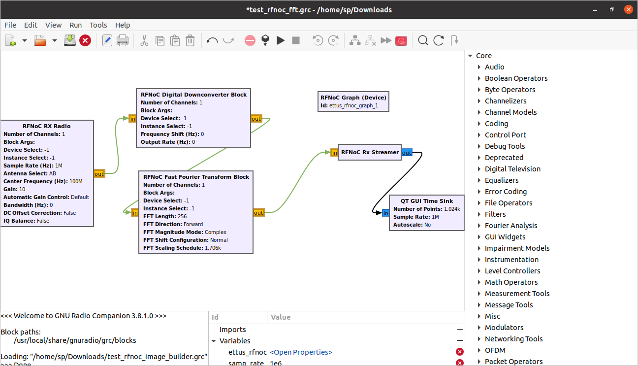

I can not understand SPP? Can you explain more? What's  SPP?  FFT size I
set to 64,128,256  and sample rate I test different values.... yet my
problem is not solved...  You can screenshot of my GRC file...
[image: Screenshot from 2022-05-30 08-39-06.png]

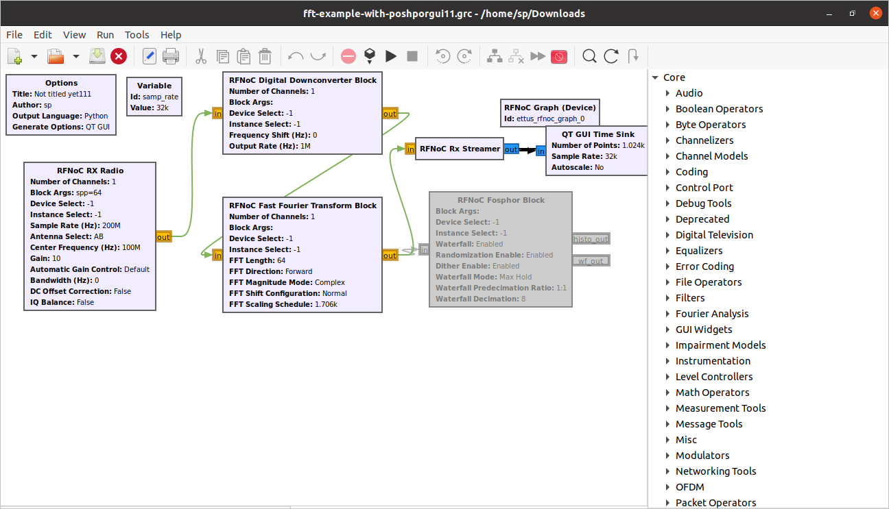

Thank you for the clarification. Finally, I used the SPP parameter, Now my
FFT block works successfully...
[image: Screenshot from 2022-06-08 11-26-06.png]

Thank you for the clarification. Finally, I used the SPP parameter, Now my FFT block works successfully... [image: Screenshot from 2022-06-08 11-26-06.png] On Tue, May 31, 2022 at 8:32 PM Wade Fife <wade.fife@ettus.com> wrote: > SPP means "Samples Per Packet". It's the size of the packets you request > from the radio. I don't know how to set this from GNU Radio (that's not my > area of expertise), but with the RFNoC API you can set the "spp" property > on the radio to set the packet size. If using MultiUSRP, you can use > set_rx_spp(). But I'm pretty sure the FFT block won't work unless the FFT > size and spp are the same. > > Also, the FFT block doesn't support FFT size of 64k. It is limited by the > maximum spp size and the maximum size supported by the IP, which is > currently 1024. > > > https://github.com/EttusResearch/uhd/blob/master/fpga/usrp3/lib/ip/axi_fft/axi_fft.xci#L134 > > I suspect that the problem you have with the Gain block and the problem > you have with the FFT block have different causes, even though they both > result in overflow. > > Wade > > On Sun, May 29, 2022 at 11:10 PM sp h <stackprogramer@gmail.com> wrote: > >> Yes! Thanks very much. >> >> Did you also test that it still works without FFT block in the RFNoC >>> graph while keeping everything else the same >> >> Yes, I did it, without FFT block, The GRC Gnuradio that includes a Radio >> core, DDC, RX streamer, and GUI time sink work successfully. >> I mention that I don't have problem with the default RFNOC block in >> USRP...All my problems is in customizing RFNOC image core like adding FFT, >> Gain, and so on... >> >> Did you configure the SPP setting to match the FFT size? This is a >>> requirement of the FFT block. >> >> I work with RFNOC image core for x300(a yml file) and set the route or >> connection between RFNOC blocks according to the link below... >> https://kb.ettus.com/Getting_Started_with_RFNoC_in_UHD_4.0 >> >> I did both of the methods: >> 1:Example: Adding an FFT Block >> 2:Example: Adding an FFT Block to the Receive Chain >> >> But both of them I faced with OOOOOOOOOOO. >> >> I can not understand SPP? Can you explain more? What's SPP? FFT size I >> set to 64,128,256 and sample rate I test different values.... yet my >> problem is not solved... You can screenshot of my GRC file... >> [image: Screenshot from 2022-05-30 08-39-06.png] >> >> >> On Sun, May 29, 2022 at 8:18 PM Wade Fife <wade.fife@ettus.com> wrote: >> >>> You do not need to recompile GNURadio and UHD from scratch each time you >>> build an FPGA bitstream. >>> >>> 'O' means overflow (the data is coming in from the radio faster than you >>> are streaming it to the host). Did you also test that it still works >>> without FFT block in the RFNoC graph while keeping everything else the same >>> (including using the same bitfile)? >>> >>> Did you configure the SPP setting to match the FFT size? This is a >>> requirement of the FFT block. >>> >>> Wade >>> >>> On Sat, May 28, 2022 at 1:16 AM sp h <stackprogramer@gmail.com> wrote: >>> >>>> When I want to customize RFNOC blocks, like adding an FFT block in >>>> Gnuradio generate OOOOOOOOOOO? >>>> When I change the RFNOC image core in USRP from the below link, the FFT >>>> block does not work in Gnuradio, For the Gain block same problem... >>>> https://kb.ettus.com/Getting_Started_with_RFNoC_in_UHD_4.0 >>>> >>>> My environment is Ubuntu 20.04 ,Gnuradio 3.8.1, UHD 4.1.0.5, gr-ettus, >>>> (I build all Gnuadio, UHD, and.... from source, Original RFNOC block >>>> works but the custom block that I added does not work correctly? >>>> >>>> My question is when I rebuild and synthesize bitstream FPGA I should >>>> compile all Gnuradio, UHD, and ....from scratch? >>>> What work should I do? I study all links and videos but my problem >>>> still remains... >>>> >>>> I saw these links that they had my problem... >>>> https://www.mail-archive.com/usrp-users@lists.ettus.com/msg11087.html >>>> >>>> https://lists.gnu.org/archive/html/discuss-gnuradio/2020-11/msg00077.html >>>> >>>> I to describe the problem in this mail..... >>>> https://lists.ettus.com/empathy/thread/76SR2TPUUXQPBWUXIWVGVIIHHHWTFRJF >>>> >>>> I shared the RFNOC image core that I added FFT but it doesn't work... >>>> Can anyone guide me? Thanks in advance >>>> >>>> _______________________________________________ >>>> USRP-users mailing list -- usrp-users@lists.ettus.com >>>> To unsubscribe send an email to usrp-users-leave@lists.ettus.com >>>> >>>

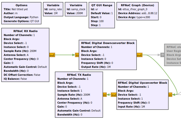

I designed the following flowgraph just to make sure I could receive,
process and transmit but even a simple receive and transmit doesn't
work. I get no graph error and the gui pops up as it would normally do.
However, the x310 I use doesn't do the job and seems inactive (no rx tx
led on). Daughterboards are basicRX and basicTX both plugged in the A
slots right now but switching and crossing channels doesn't change anything.
What am I missing?
Maxime
