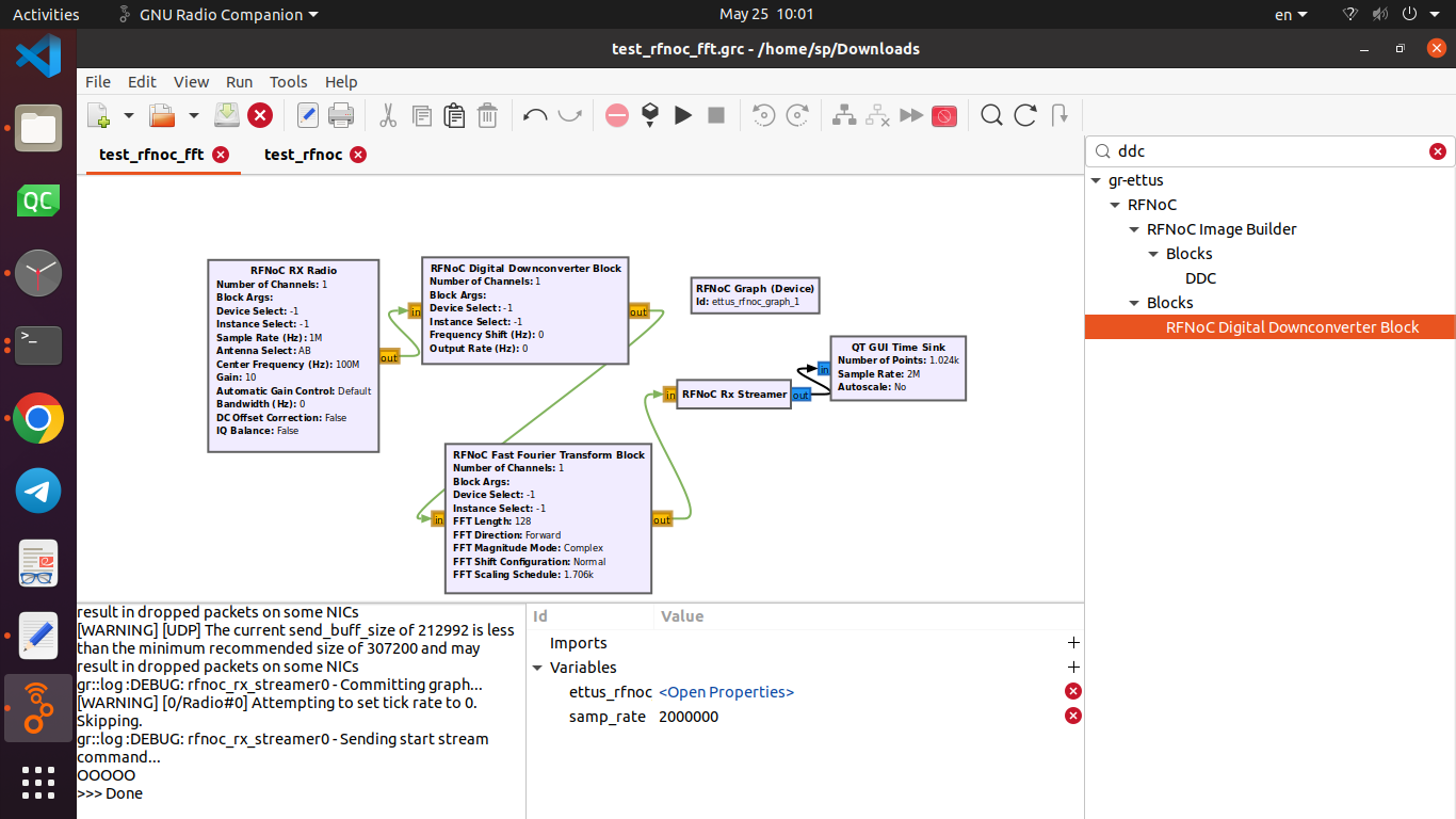

When I used this doc
https://kb.ettus.com/Getting_Started_with_RFNoC_in_UHD_4.0 and add the
FFT block to the USRP x300 block not work correctly and send the command
OOOOOO...
For another original block, I had the same problem...How can solve my
problem?
Errors:
gr::log :DEBUG: rfnoc_rx_streamer0 - Committing graph...
[WARNING] [0/Radio#0] Attempting to set tick rate to 0. Skipping.
gr::log :DEBUG: rfnoc_rx_streamer0 - Sending start stream command...
OOOOOOOOOOOOOOOOOOOOOOOOOOOOOOOOOOOOOOOOOOOOOOOOOOOOOOOOOOOOOOOOOO
[image: Screenshot from 2022-05-25 10-01-56.png]

This is my image core yml file...

I closed this thread. Finally my problem is solved by adding spp parameter
in RFNOC Radio core blocks. more info
see this link
https://lists.ettus.com/empathy/thread/VJB7A53C6X77JN7DPP3ATASYO4MAH7GH
