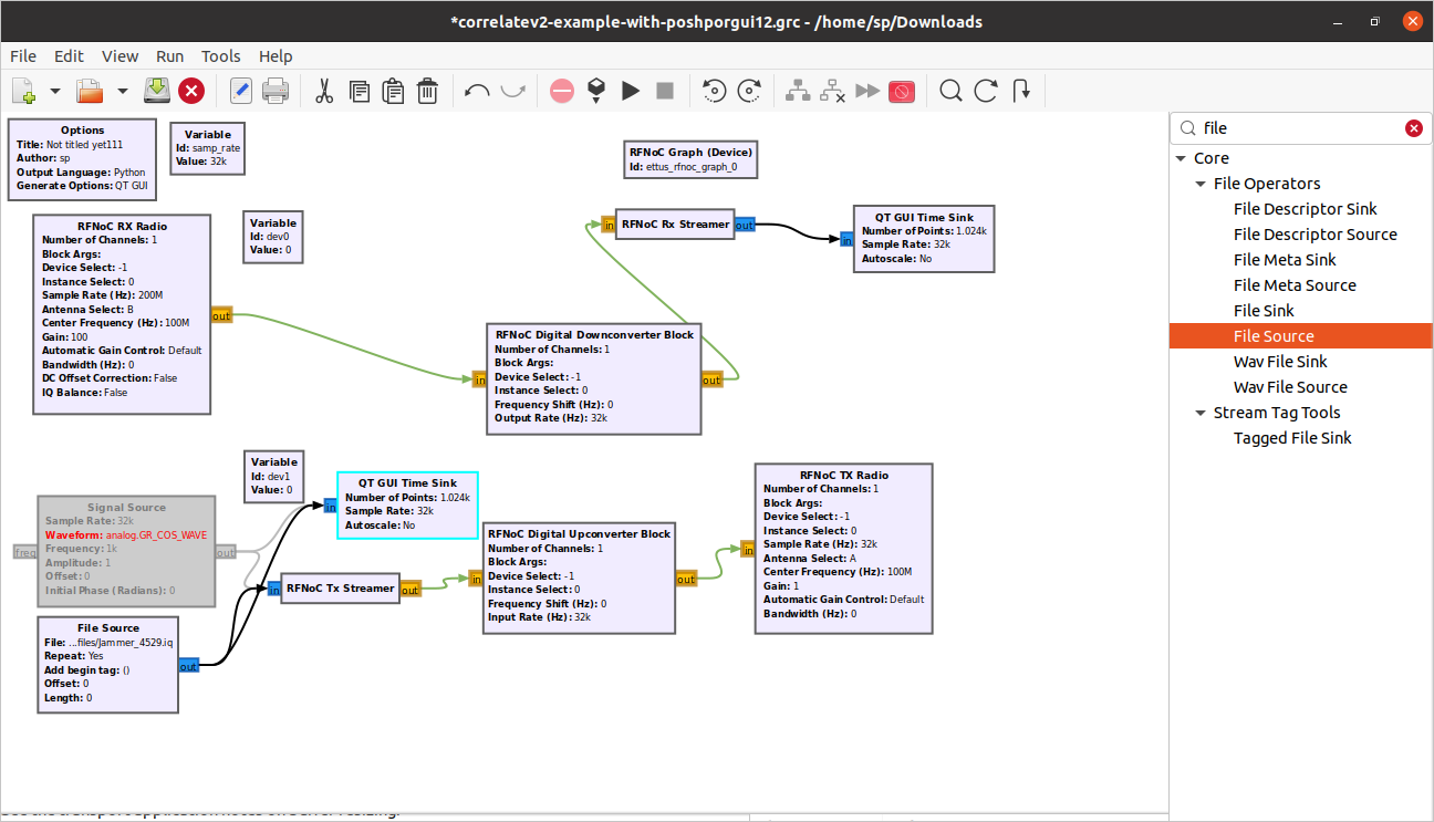

Thanks for the tip! But I have a TX and RX with USRP. I used a gain block
for TX and a multiply block for RX.
When In Receiver or RX multiply result is more than a threshold...I want to
change the gain block in TX or Transmitter...
See the screenshot below, I need two blocks be separately ........
[image: image.png]
