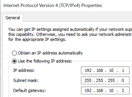

I also have an older n200 that requires firmware and FPGA updates.  The
n200 is connected to a USB-to-RJ45 adapter on my laptop with the following
configuration:

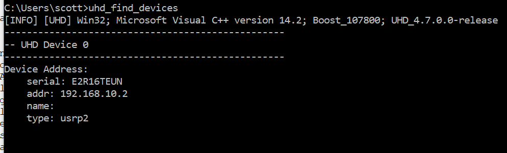

I can use the uhd_find_devices command to find the n200 when it is
connected to my LAN, and the following information is provided:

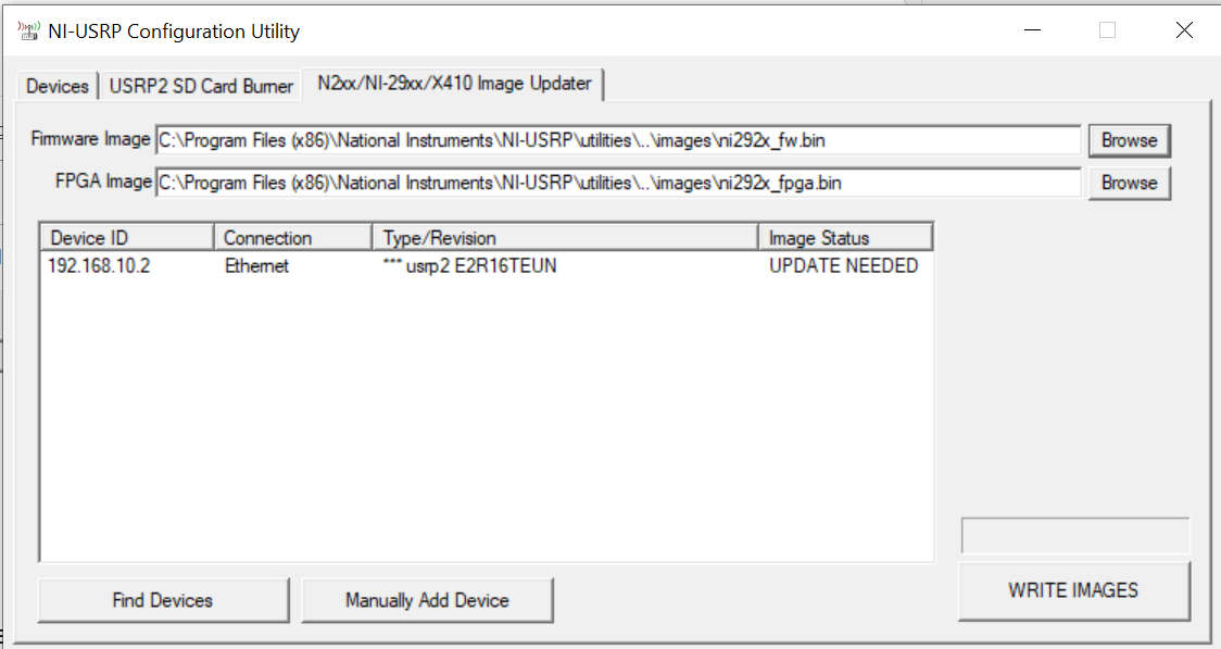

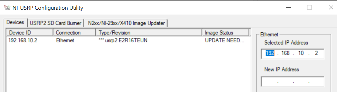

The uhd_find_devices command does not work when the n200 is connected to
the USB-to-RJ45 port.  However, the NI-USRP Configuration Utility is able
to find the n200, as shown here:

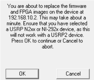

As you can see, the firmware needs to be updated to use the n200 with
MATLAB.  I attempted to update the firmware using the NI-USRP Configuration
Utility, but this was not successful due to a compatibility error, as shown
here:
Do you have a procedure I can follow to fix this problem so the firmware
can be updated for the n200?
