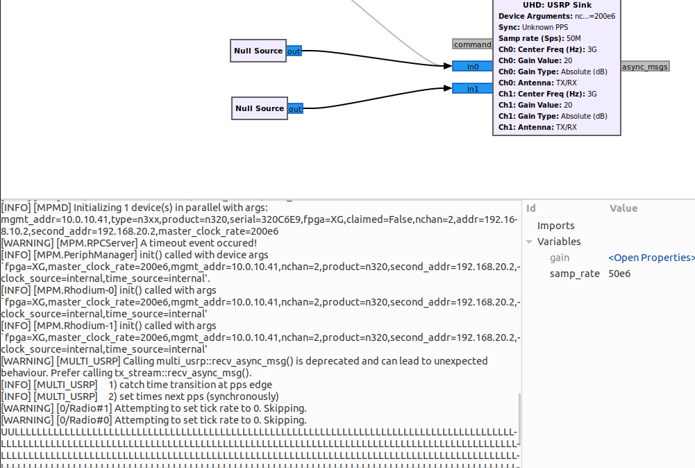

Unfortunately, that doesn’t work neither. Same error is occured again. I can understand why it dropped packets (cecause of PC or NIC) but I have no clue about why it stops transmitting.

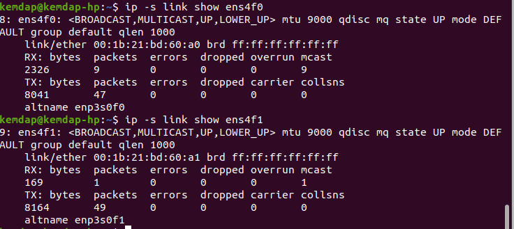

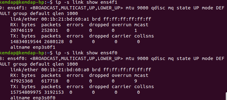

Could you check the error counters on your network card before and after
you start a "run" where this happens?

Hello Marcus,
  • I attached the related pictures of error counters. There is no problem caused by NIC.
  • There is also problem with 5 Msps sample rate but it took longer time (almost 4 minutes) to give error. When I increase the sample rate it took shorter time to give error.
    • TX at 5 Msps gives error after 4 minutes
    • TX at 10 Msps gives error after 2.5 minutes
    • TX at 20 Msps gives error after 1.5 minutes
    • TX at 50 Msps gives error after 50 seconds
  • I am running on native hardware. Ubuntu 20.04 and UHD 4.1.

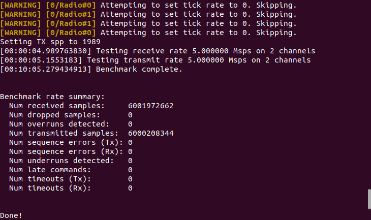

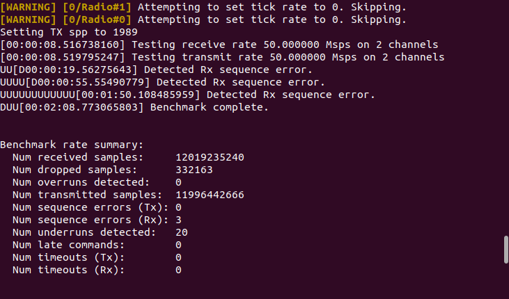

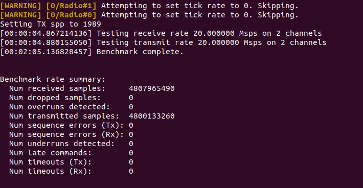

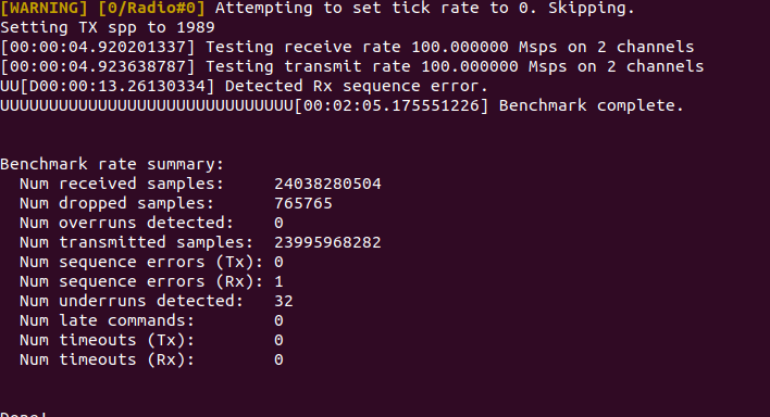

Hello Rob,
I got same error when operating on “benchmark_rate”. I attached the related pictures.
  • At 5 Msps, duration = 10 minutes —> No error
  • At 20 Msps, duration = 2 minutes —> No error
  • At 25 Msps, duration = 2 minutes —> Error detected
  • At 50Msps, duration = 2 minutes —> Error detected
  • At 100 Msps, duration = 2 minutes —> Error detected
In addition, when I got “U” errors while running “benchmark_rate”, it continues to transmit.
Hello Rob, I got same error when operating on “benchmark_rate”. I attached the related pictures. * At 5 Msps, duration = 10 minutes —> No error * At 20 Msps, duration = 2 minutes —> No error * At 25 Msps, duration = 2 minutes —> Error detected * At 50Msps, duration = 2 minutes —> Error detected * At 100 Msps, duration = 2 minutes —> Error detected In addition, when I got “U” errors while running “benchmark_rate”, it continues to transmit.

Ok. If benchmark_rate fails, this means that either your host is not
optimized or else it is underpowered, I think.  Did you try the items at this
https://kb.ettus.com/USRP_Host_Performance_Tuning_Tips_and_Tricks#Adjust_Network_Bufferslink?
Are you getting any error messages or warnings (other than those shown)
when you run benchmark_rate?  How about rx_streaming - are you able to
consume Rx streaming at high rates without errors?
