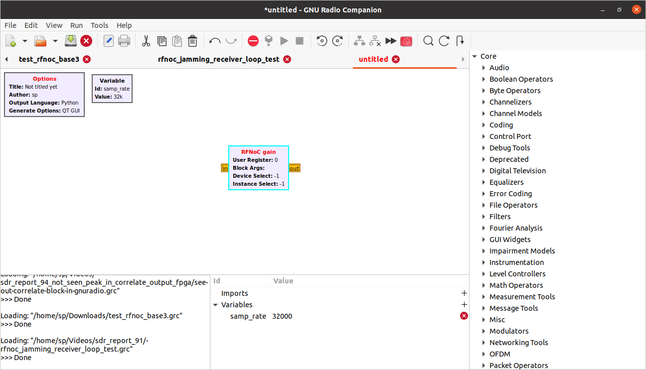

I am developing some RFNOC blocks, When I use rfnocmodtool in the terminal
to create a new block?
Default in the block that is generated there is a User Register? my
question is how can create 3 custom registers with the command rfnocmodtool?
How can do this work automatically? is it possible? and what's
the limitation of number (of registers) that we can use in RFNOC blocks?
Thanks in advance
rfnocmodtool add gain
[image: Screenshot from 2022-08-22 11-56-22.png]

Hi sp,
I don't think the modtool supports adding a customer number of registers.
The generated templates include a user register as an example. You can add
your own registers by adding them to the generated code following the
example of the user register. The RFNoC blocks in UHD also have lots of
examples of registers.
RFNoC doesn't really have a limit for the number of registers. The address
bus is 20 bits, so in practice you'll probably run out of space on the FPGA
before you hit the address space limit, and there are ways around address
space limits.
Wade
