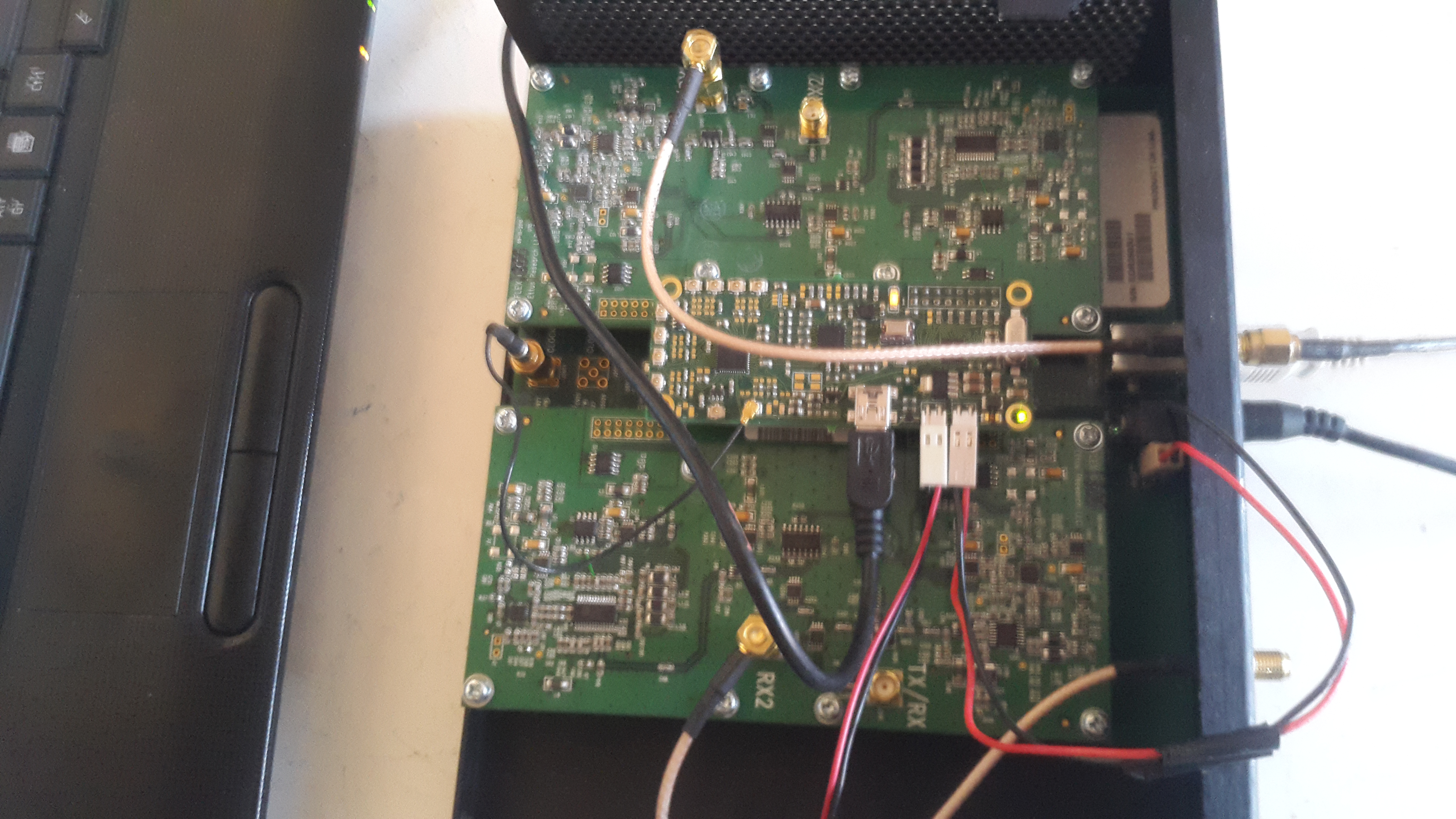

Hello Cristian:
Could you please provide more details?? The only power cable that I'm aware
of on the ClockTamer is the 2-wire power cable (it's not a USB power
cable). Is your ClockTamer not getting any power? Does the USRP1 still work
at all, aside from running Kalibrate? Are you able to run
"rx_samples_to_file", "rx_ascii_art_dft", or "uhd_fft", or some other
similar simple test?? Does it still respond to "uhd_usrp_probe" and
"uhd_find_devices"??
--Neel

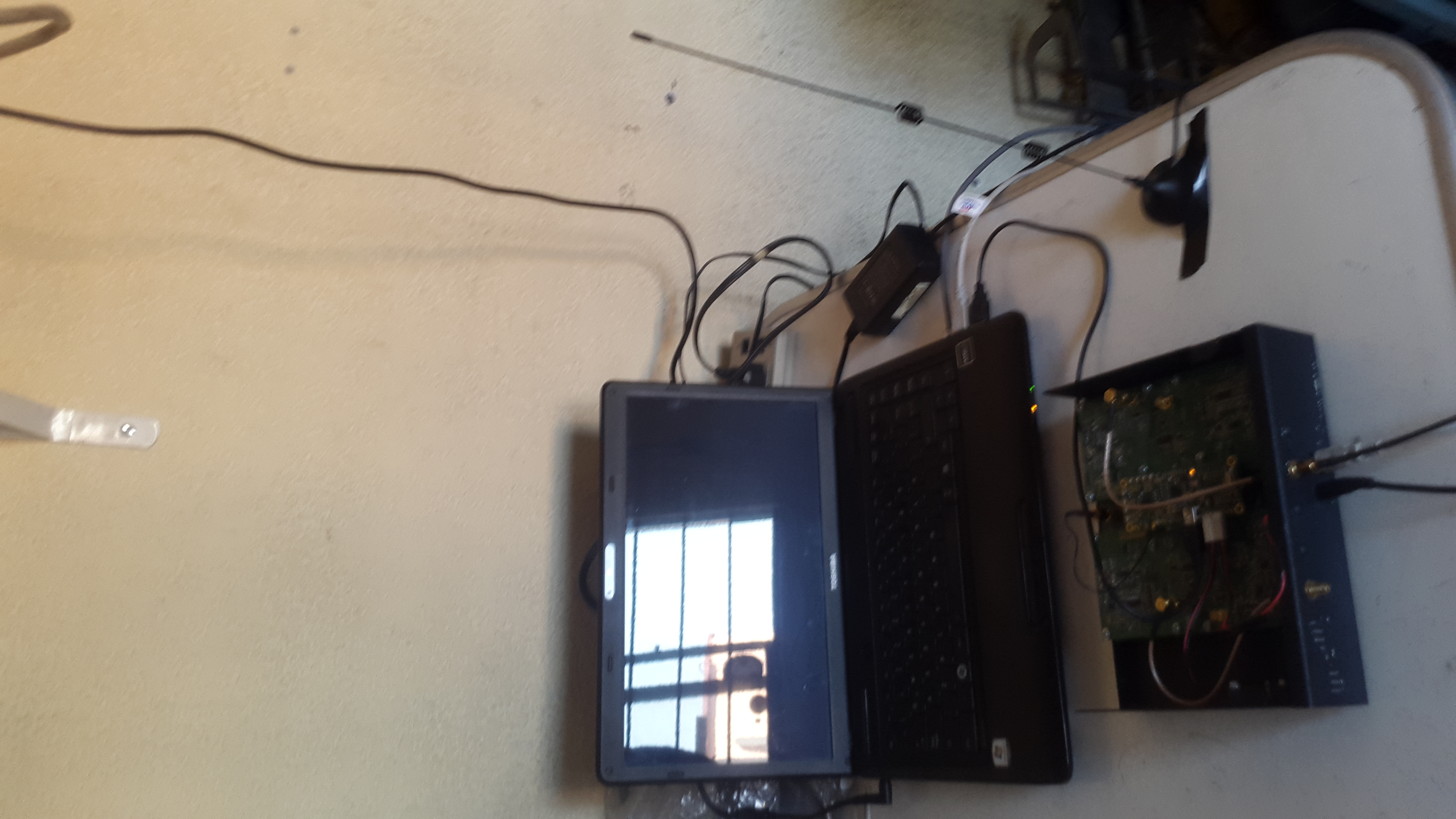

Hello Neel, thank you for your answer.
I'm attaching 2 pictures to show you more.
Regarding other tests, really i'm not familiar running this test, for
this i'm looking
for help,  but i will try to find and run the scripts, what output i
need to expect?.
Thank you, regards
Cristian
