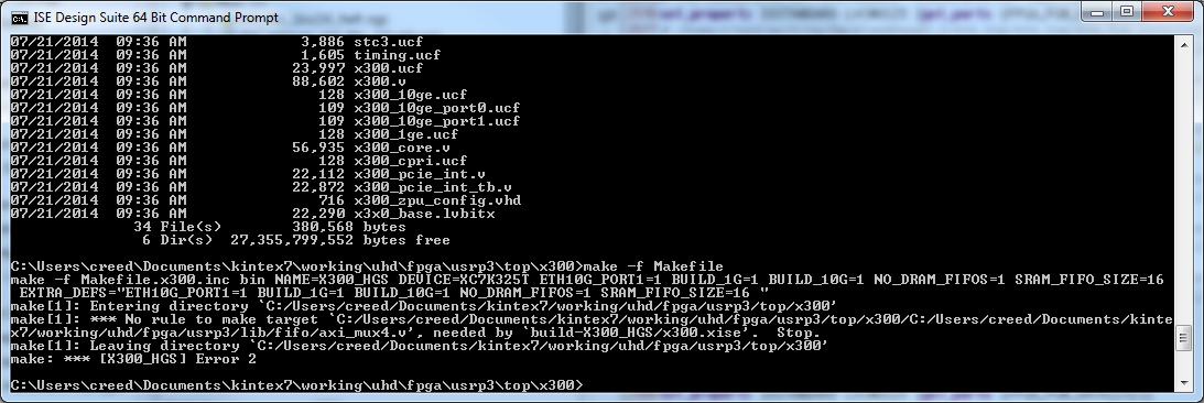

Hi Chuck - What is the 'make' command you are trying to run? Can you show us your command line? Cheers, Ben On Tue, Jul 22, 2014 at 11:30 AM, Marcus D. Leech via USRP-users < usrp-users@lists.ettus.com> wrote: > On 07/22/2014 02:22 PM, chuck reed wrote: > >> Thanks. Actually, I started there ( I should've mentioned that). The >> error I get there >> is: *** No rule to make target >> >> The full error message is (from running make -f Makefile X310): >> C:\Users\creed\Documents\kintex7\working\uhd\fpga\usrp3\top\x300> make >> -f Makefile X310 >> make -f Makefile.x300.inc bin NAME=X310_HGS DEVICE=XC7K410T >> ETH10G_PORT1=1 BUILD_1G=1 BUILD_10G=1 NO_DRAM_FIFOS=1 SRAM_FIFO_SIZE=16 >> EXTRA_DEFS="ETH10G_PORT1=1 BUILD_1G=1 BUILD_10G=1 NO_DRAM_FIFOS=1 >> SRAM_FIFO_SIZE=16 " >> make[1]: Entering directory `C:/Users/creed/Documents/ >> kintex7/working/uhd/fpga/usrp3/top/x300' >> make[1]: *** No rule to make target `C:/Users/creed/Documents/ >> kintex7/working/uhd/fpga/usrp3/top/x300/C:/Users/creed/Documents/kinte >> x7/working/uhd/fpga/usrp3/lib/fifo/axi_mux4.v', needed by >> `build-X310_HGS/x300.xise'. Stop. >> make[1]: Leaving directory `C:/Users/creed/Documents/ >> kintex7/working/uhd/fpga/usrp3/top/x300' >> make: *** [X310_HGS] Error 2 >> >> Makes me think I'm just not invoking make correctly, but I'm not sure >> what the correct syntax should be. The path >> doesn't look right (the path to axi_mux4.v isn't that long) the first >> `C:/Users/creed/Documents/kintex7/working/uhd/fpga/usrp3/top/x300/ is >> not part of the path to the needed file. C:/Users/creed/Documents/ >> kintex7/working/uhd/fpga/usrp3/lib/fifo/ is correct, but >> concatenated like that, that path doesn't exist. >> >> I've also tried >> > make -f Makefile >> > make of Makefile x310 >> >> Thanks for your help. Are there any examples of how to build the X310 >> design? Some of the READMEs >> I've seen in usrp3 are empty. >> >> Regards, >> >> You may have to build yourself a Linux Xilinx environment--I'm not sure > that those Makefiles work under Windows. But I'll let someone from > the FPGA team comment further. > > > > > > _______________________________________________ > USRP-users mailing list > USRP-users@lists.ettus.com > http://lists.ettus.com/mailman/listinfo/usrp-users_lists.ettus.com >
CR
chuck reed
Fri, Aug 1, 2014 6:28 PM
Sure.  An image is attached.

Sure. An image is attached. Regards, On Fri, Aug 1, 2014 at 2:18 PM, Ben Hilburn <ben.hilburn@ettus.com> wrote: > Hi Chuck - > > What is the 'make' command you are trying to run? Can you show us your > command line? > > Cheers, > Ben > > > On Tue, Jul 22, 2014 at 11:30 AM, Marcus D. Leech via USRP-users < > usrp-users@lists.ettus.com> wrote: > >> On 07/22/2014 02:22 PM, chuck reed wrote: >> >>> Thanks. Actually, I started there ( I should've mentioned that). The >>> error I get there >>> is: *** No rule to make target >>> >>> The full error message is (from running make -f Makefile X310): >>> C:\Users\creed\Documents\kintex7\working\uhd\fpga\usrp3\top\x300> make >>> -f Makefile X310 >>> make -f Makefile.x300.inc bin NAME=X310_HGS DEVICE=XC7K410T >>> ETH10G_PORT1=1 BUILD_1G=1 BUILD_10G=1 NO_DRAM_FIFOS=1 SRAM_FIFO_SIZE=16 >>> EXTRA_DEFS="ETH10G_PORT1=1 BUILD_1G=1 BUILD_10G=1 NO_DRAM_FIFOS=1 >>> SRAM_FIFO_SIZE=16 " >>> make[1]: Entering directory `C:/Users/creed/Documents/ >>> kintex7/working/uhd/fpga/usrp3/top/x300' >>> make[1]: *** No rule to make target `C:/Users/creed/Documents/ >>> kintex7/working/uhd/fpga/usrp3/top/x300/C:/Users/creed/Documents/kinte >>> x7/working/uhd/fpga/usrp3/lib/fifo/axi_mux4.v', needed by >>> `build-X310_HGS/x300.xise'. Stop. >>> make[1]: Leaving directory `C:/Users/creed/Documents/ >>> kintex7/working/uhd/fpga/usrp3/top/x300' >>> make: *** [X310_HGS] Error 2 >>> >>> Makes me think I'm just not invoking make correctly, but I'm not sure >>> what the correct syntax should be. The path >>> doesn't look right (the path to axi_mux4.v isn't that long) the first >>> `C:/Users/creed/Documents/kintex7/working/uhd/fpga/usrp3/top/x300/ is >>> not part of the path to the needed file. C:/Users/creed/Documents/ >>> kintex7/working/uhd/fpga/usrp3/lib/fifo/ is correct, but >>> concatenated like that, that path doesn't exist. >>> >>> I've also tried >>> > make -f Makefile >>> > make of Makefile x310 >>> >>> Thanks for your help. Are there any examples of how to build the X310 >>> design? Some of the READMEs >>> I've seen in usrp3 are empty. >>> >>> Regards, >>> >>> You may have to build yourself a Linux Xilinx environment--I'm not sure >> that those Makefiles work under Windows. But I'll let someone from >> the FPGA team comment further. >> >> >> >> >> >> _______________________________________________ >> USRP-users mailing list >> USRP-users@lists.ettus.com >> http://lists.ettus.com/mailman/listinfo/usrp-users_lists.ettus.com >> > > -- -Chuck dashCdot@gmail.com

FWIW, I borrowed a Linux box and  make -f Makefile worked fine.
Unfortunately, I need to
get this working on my 64bit Win7 machine. My only problem with the Linux
build is that it
built everything.  I just need to build the X310.
Regards,
On Fri, Aug 1, 2014 at 2:18 PM, Ben Hilburn ben.hilburn@ettus.com wrote:
Hi Chuck -
command line?
