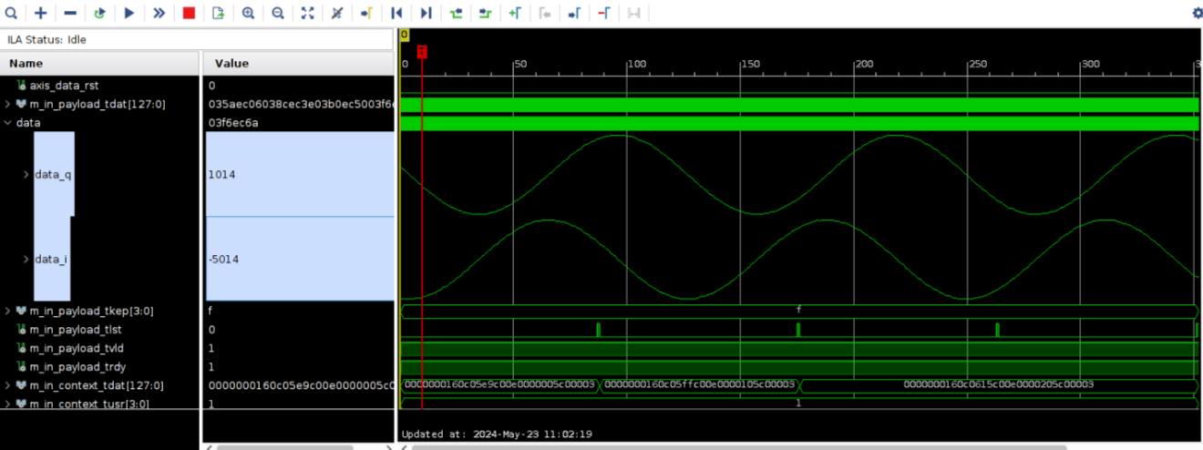

Hello,
We are using an NI Ettus USRP X410 SDR. We have been successful in programming the FPGA images that are default UHD designs as well as our own custom FPGA design utilizing a singular RFNoC block.
Once we integrated our FPGA Design which includes an ILA to view what the signal looks like at the input/output of our block we observed a tone that would be generated any time the stream command would be set, regardless if a tone was present or not.
[cid:image001.png@01DAD794.0F1FE0D0]
The SW used was based of the rfnoc_rx_to_file script, with the addition solely being specifying the RFNoC block added. Other than that the script was not changed. It was observed that the frequency of the unknown tone would change as the LO was tuned via the "freq" flag.

The main question is where is the tone originating from when streaming if not through the signal generator, is there some internal DDS being configured upon tuning? Or what other scripts can be used to verify using the RFNoC SW API. Thanks!

  • I'm not sure about the tone, but when you RX without your block into a
    GUI application (like uhd_fft, gqrx, or, if you're being super
    minimalistic, rx_ascii_art_dft), do you see a tone in the spectrum? Maybe
    it's some naturally occurring leakage. ILAs are great tools, but not always
    ideal for detailed analysis of signals. There are a bunch of LOs and
    there's a DDS in the RFSoC, but the DDS shouldn't be present here.
