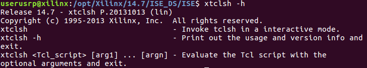

I installed the Xilinx tools. I can find xtclsh on
/opt/Xilinx/14.7/ISE_DS/ISE/bin/lin/xtclsh. Moreover, xtclsh is also
set up in my environment. See figure below.
[image: Inline images 1]
Have anyone faced any related problem?

There's absolutely no reason to run "make" as root.  When you run sudo,
your PATH variable, by default is not inherited by the root shell that
is created.

Hi Marcus,
You are right! When I ran without sudo, I had a problem with file
permissions. Sudo was a lazy working around and it ended up being a bad
one. 😬 That's said, everything works fine now. Thanks for you help!
