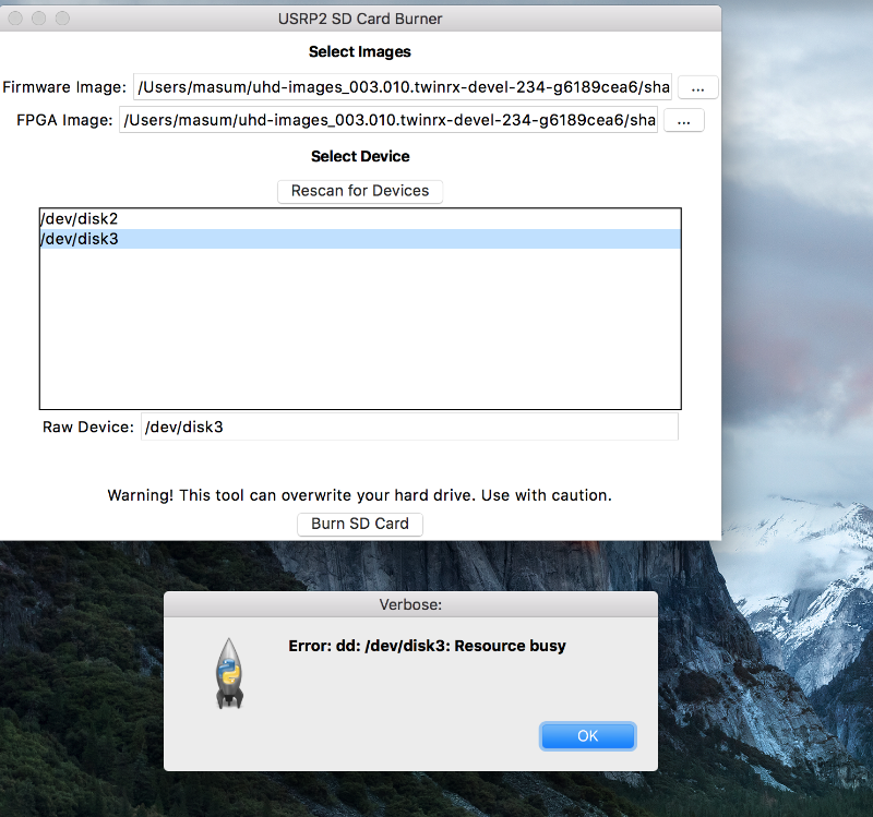

Hi,Currently, I am working with USRP2 device for my research. I have been trying to activate this previously used device for last three days but failed to make it talk to my computer(Mac OSx El Capitan) via ping command (usb2 ethernet adapter is used for connection between computer and device; also direct ethernet cable connection was tested with another pc but seems the device is dead, no response!). Then I assumed the there might be a firmware issue. I erased the sd card and tried to copy usrp2_fw.bin and usrp2_fpga.bin files via sdcard_burner_gui.py program but the program was giving an error saying "the dd/disk3: resource is busy!". However, Then I tried to copy those files by drag and dropping them, which copied well but couldn't help to communicate the device. The device loads the firmware first and stays with only F LED indicator lit up. In this instance, I need suggestion what should I do to make it run! P.S. bin files are collected from uhd-images_003.010.twinrx-devel-234-g6189cea6 folder from ettus support website. Thanks
