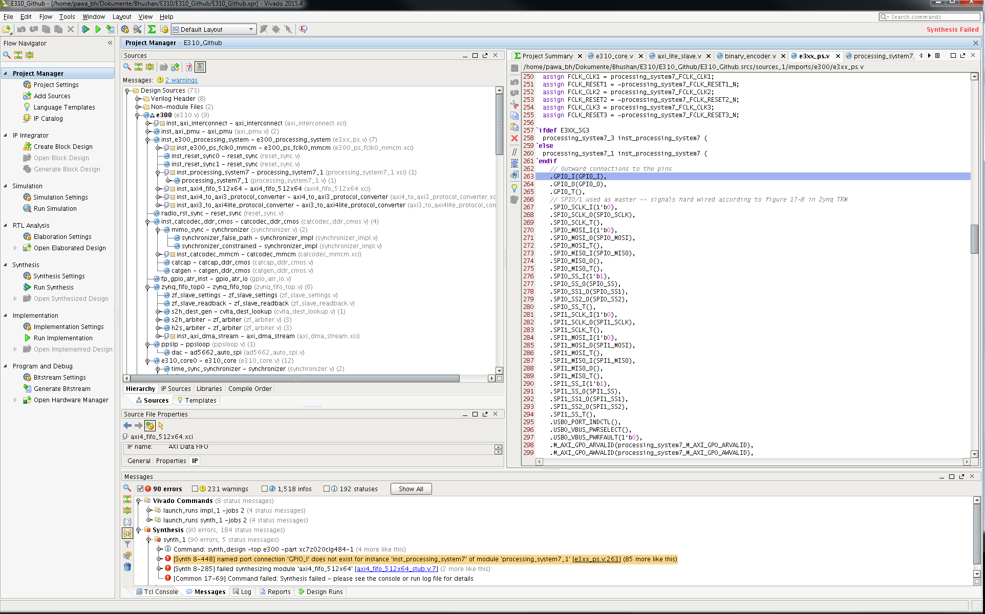

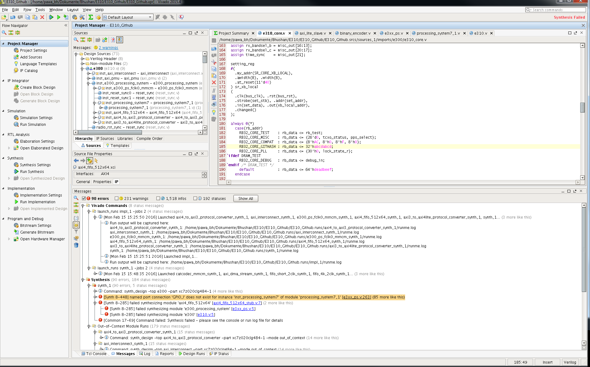

Errors:
[Synthv8-448] named port connection 'GPIO_I' does not exist for
instance 'inst_processing_system7' of module 'processing_system7_1'
[e3xx_ps.v.263]
(85 more like this)
[Synthv8-285] failed synthesizing module 'axi4_fifo_512x64'
[axi4_fifo_512x64_stub.v.7]
(2 more like this)
Thanks & Regards,
Bhushan R.V. Pawar.

I am using the source code from Github  usrp3/top/e300 and trying to
synthesize the code. However, I am getting these errors. Kindly help.
[image: Inline image 2][image: Inline image 1]

Errors:
[e3xx_ps.v.263]
(85 more like this)
(2 more like this)
to synthesize the code. However, I am getting these errors. Kindly help.
