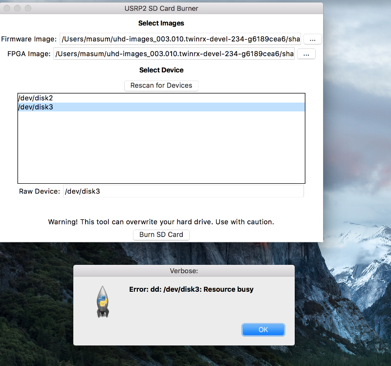

Hello Mahbubur Rahman:
What is the exact command that you're using to burn the SD Card??
Make sure that the SD Card is not mounted or in use when you're trying to
write to it.
You mentioned that you're using
uhd-images_003.010.twinrx-devel-234-g6189cea6. You should be using a tagged
release of UHD, such as 3.9.4. The images for 3.9.4 are here:
http://files.ettus.com/binaries/images/uhd-images_003.009.004-release.tar.gz
--Neel Pandeya

Hi,
Currently, I am working with USRP2 device for my research. I have been
trying to activate this previously used device for last three days but
failed to make it talk to my computer(Mac OSx El Capitan) via ping command
(usb2 ethernet adapter is used for connection between computer and device;
also direct ethernet cable connection was tested with another pc but seems
the device is dead, no response!). Then I assumed the there might be a
firmware issue. I erased the sd card and tried to copy usrp2_fw.bin and
usrp2_fpga.bin files via sdcard_burner_gui.py program but the program was
giving an error saying "the dd/disk3: resource is busy!". However, Then I
tried to copy those files by drag and dropping them, which copied well but
couldn't help to communicate the device. The device loads the firmware
first and stays with only F LED indicator lit up. In this instance, I need
suggestion what should I do to make it run! P.S. bin files are collected
from
uhd-images_003.010.twinrx-devel-234-g6189cea6 folder from ettus support
website. Thanks
[image: Inline image]
