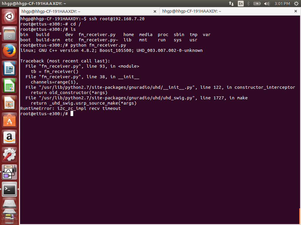

Hi,
Please find attached the snapshot of error we have got while executing the
python code on USRP E310.
We are using the USRP for the first time. Kindly treat it as little urgent
and help us.

Hi, Please find attached the snapshot of error we have got while executing the python code on USRP E310. We are using the USRP for the first time. Kindly treat it as little urgent and help us. Thanks & Best Regards ADM Rao, Sr. Manager - Technology Division II Mobile: 919900399378 Captronic Systems Pvt. Ltd. An ISO 9001:2008, CSIA Level-1 Certified Company Plot No: 3,Victorian Meadows, Airport Varthur Main Road, Marthahalli Post, Bangalore : 560037. Ph: +91-80-40373900, Extn.: 120; Fax No: +91-80-40373839. E-mail: <mailto:malleswara@captronicsystems.com> malleswara@captronicsystems.com I Website: <http://www.captronicsystems.com/> www.captronicsystems.com CIN:U72200KA2004PTC033141 Please do not print this email unless it is absolutely necessary. This email message and any attachments is confidential and intended only for the use of an individual or entity named above and may contain information that is privileged, confidential or exempt from disclosure under applicable law. If you are not the intended recipient, you are notified that any dissemination, distribution or copying of this email is strictly prohibited. Captronic Systems Pvt Ltd does not accept liability for any errors, omissions, corruption or virus in the contents of this message or any attachments that arise as a result of e-mail transmission. If you have received this communication in error, please notify the sender immediately and delete the original message and its attachments immediately. -- Please do not print this email unless it is absolutely necessary. This email message and any attachments is confidential and intended only for the use of an individual or entity named above and may contain information that is privileged, confidential or exempt from disclosure under applicable law. If you are not the intended recipient, you are notified that any dissemination, distribution or copying of this email is strictly prohibited. Captronic Systems Pvt Ltd does not accept liability for any errors, omissions, corruption or virus in the contents of this message or any attachments that arise as a result of e-mail transmission. If you have received this communication in error, please notify the sender immediately and delete the original message and its attachments immediately.

On 08/20/2015 08:35 AM, Malleswara Rao via USRP-users wrote:
Hi,
Before proceeding, I suggest getting an 8 GB sd card and updating the
E310 to use the current factory image from:
http://files.ettus.com/e3xx_images/e3xx-release-3/
Use the file  sdimage-gnuradio-dev.direct.xz
and write it to an 8 GB sd card with bmaptool.
http://gnuradio.org/redmine/projects/gnuradio/wiki/Copy_an_image_file_to_the_SD_card
Philip

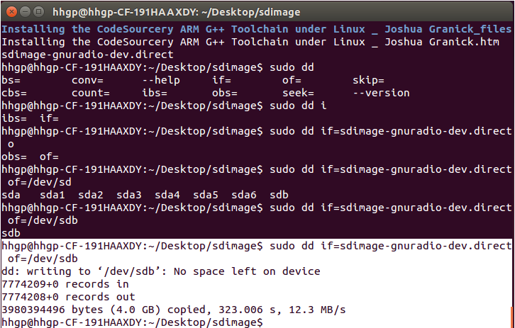

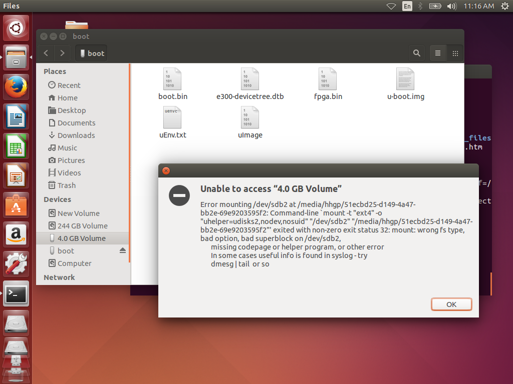

Hi Philip,
We have tried to fuse the new image that is downloaded through the link that
you have provided. The process was not successful. I have attached the
snapshots of the error messages.
Please help us in addressing this issue.

Hi Philip, We have tried to fuse the new image that is downloaded through the link that you have provided. The process was not successful. I have attached the snapshots of the error messages. Please help us in addressing this issue. Thanks & Regards ADM Rao -----Original Message----- From: Philip Balister [mailto:philip@opensdr.com] Sent: Thursday, August 20, 2015 7:46 PM To: Malleswara Rao; usrp-users@lists.ettus.com Subject: Re: [USRP-users] Support request-USRP E310 On 08/20/2015 08:35 AM, Malleswara Rao via USRP-users wrote: > Hi, > Before proceeding, I suggest getting an 8 GB sd card and updating the E310 to use the current factory image from: http://files.ettus.com/e3xx_images/e3xx-release-3/ Use the file sdimage-gnuradio-dev.direct.xz and write it to an 8 GB sd card with bmaptool. http://gnuradio.org/redmine/projects/gnuradio/wiki/Copy_an_image_file_to_the _SD_card Philip > > > Please find attached the snapshot of error we have got while executing > the python code on USRP E310. > > We are using the USRP for the first time. Kindly treat it as little > urgent and help us. > > Thanks & Best Regards > > ADM Rao, Sr. Manager - Technology Division II Mobile: 919900399378 > > > > > Captronic Systems Pvt. Ltd. > > An ISO 9001:2008, CSIA Level-1 Certified Company > > Plot No: 3,Victorian Meadows, Airport Varthur Main Road, Marthahalli > Post, Bangalore : 560037. > > Ph: +91-80-40373900, Extn.: 120; Fax No: +91-80-40373839. > > E-mail: <mailto:malleswara@captronicsystems.com> > malleswara@captronicsystems.com I Website: > <http://www.captronicsystems.com/> www.captronicsystems.com > > CIN:U72200KA2004PTC033141 > > > > Please do not print this email unless it is absolutely necessary. > > This email message and any attachments is confidential and intended > only for the use of an individual or entity named above and may > contain information that is privileged, confidential or exempt from > disclosure under applicable law. If you are not the intended > recipient, you are notified that any dissemination, distribution or copying of this email is strictly prohibited. > > > > Captronic Systems Pvt Ltd does not accept liability for any errors, > omissions, corruption or virus in the contents of this message or any > attachments that arise as a result of e-mail transmission. If you have > received this communication in error, please notify the sender > immediately and delete the original message and its attachments immediately. > > > > > > > _______________________________________________ > USRP-users mailing list > USRP-users@lists.ettus.com > http://lists.ettus.com/mailman/listinfo/usrp-users_lists.ettus.com > -- Please do not print this email unless it is absolutely necessary. This email message and any attachments is confidential and intended only for the use of an individual or entity named above and may contain information that is privileged, confidential or exempt from disclosure under applicable law. If you are not the intended recipient, you are notified that any dissemination, distribution or copying of this email is strictly prohibited. Captronic Systems Pvt Ltd does not accept liability for any errors, omissions, corruption or virus in the contents of this message or any attachments that arise as a result of e-mail transmission. If you have received this communication in error, please notify the sender immediately and delete the original message and its attachments immediately.

The card that comes with the unit is likely still a 4gb card, you need to write the new image to an 8gb card.
Philip
urgent and help us.

The new image needs an 8gb card. Your screen shots suggest you are using a smaller card.
that

Hi Philip,
Hi,
