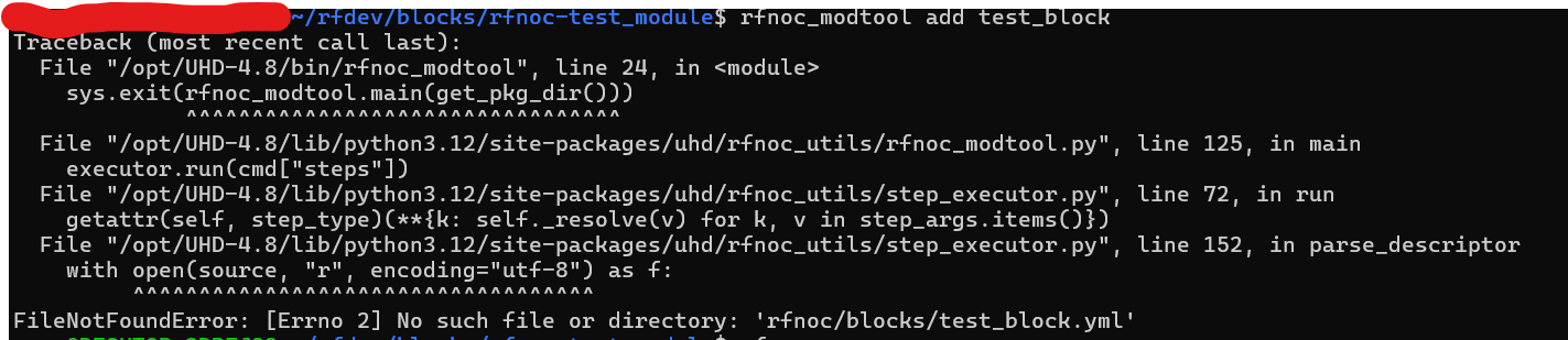

Hello,
All my experience in UHD is in UHD4.6. I am trying out UHD 4.8 because of
the upgrades to rfnoc_image_builder, and I tried making a test module with
rfnoc_modtool.
Running "rfnoc_modtool create test_module" completes successfully, however
running "rfnoc_modtool add test_block" generates the following error:
[image: image.png]
The test_block.yml indeed doesn't exist, and I am wondering if the
intention is that I add it myself, or if the creation of the file was
accidentally omitted.

Hi David,
and sorry for stumbling over the lack of documentation for this (fairly
new) tool. Yes, the idea is that you create the YAML. rfnoc_modtool add
will then generate the HDL, noc_shell, block controller templates, etc.
We've been internally discussing a kind of YAML creation wizard -- would
that be of interest to you? What should it do in your opinion?
--M
