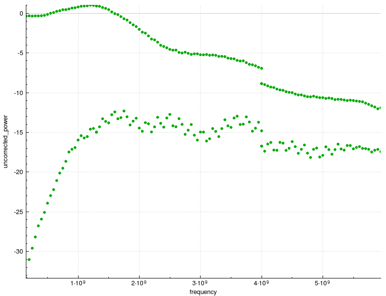

Hello,
I'm seeing some strange behavior on some new b205 we've received. These
units are Rev Cs so they should have the new caps at the receive switch
in order to remove the transient behavior I had highlighted in a
previous exchange. Two different units exhibit this exact behavior. The
plot below shows received power in dB (in this case 10 dB = full scale,
not 0)
The top plot is RX2 and the bottom one is Tx/Rx. I would expect both of
these to be very similar, however, there is a significant difference.
This occurs over all gain settings.
We had done some reworks in house of the older boards with the correct
caps an did not see this behavior. Is it possible that something is not
working as expected in the rev Cs? Any idea what could be causing this
behavior?
