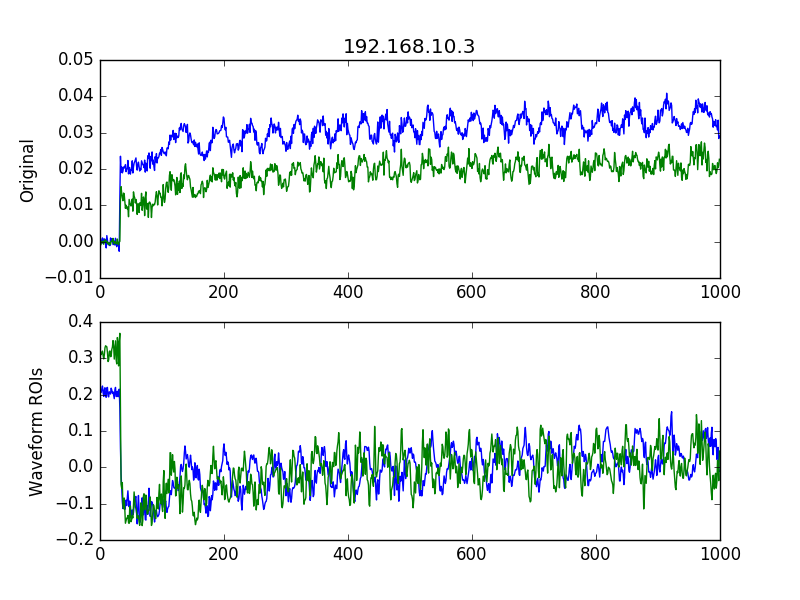

Hi all,
We're currently developing a demo around 4 USRP X310s, each of which is
connected to a host PC through a gigabit ethernet switch. The host PC is
using the GNU Radio interface to UHD installed via apt-get. Through a bit
of trail and error, we've been able to receive ~9000 contiguous samples @
100M samples/second from one USRP at a time before an overflow occurs.
We're assuming that the overflows are due to limitations in the connection
capacity.
Despite this, large chunks of dropped samples are a non-issue for our
application. We're more concerned about maintaining an extremely high
sampling rate and acquiring short bursts of contiguous samples. However, we
noticed that overflows cause the radio to re-initialize the RF front-end
boards, which results in a rather undesirable transient behavior (see
attachment). Is there any way to "ignore" these buffer overflows?
If this requires us to modify and recompile any host-side UHD code, we're
happy to do it.
Thanks in advance!

it's not quite that simple. When the radio overruns, it actually stops
doing anything. What the host does is actually re-start it so you get
any more samples at all.
You might be better off doing timed receive bursts. If you want to use
RFNoC, you can even use the DRAM FIFO to add 32 MB of FIFOs on the FPGA.
Cheers,
M

Thanks for the prompt reply! My initial understanding was that we could do
timed bursts by specifying NUM_SAMPS_AND_DONE when issuing stream commands,
but this seems to result in a restart every time recv() is called. Is there
a way to do these timed receive bursts without incurring transients?

No, but you can start streaming a bit too early and discard samples.

Unfortunately, we can't seem to acquire enough continuous samples for the
transient behavior to die off. I assume adding an RX FIFO to the FPGA
should fix the problem we're currently having, correct?
