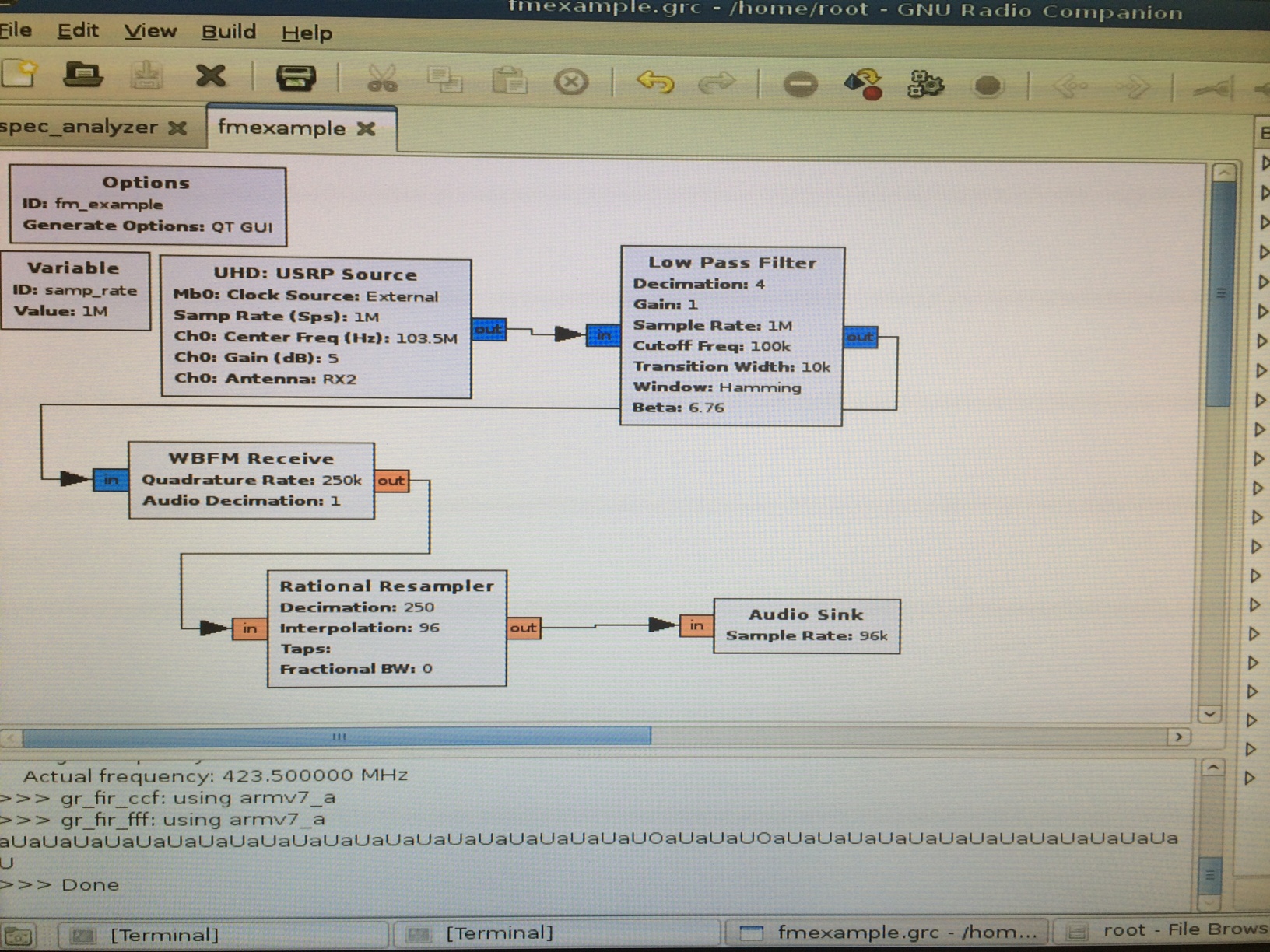

Hi everybody,
I'm trying to implement FM receiver on usrp e110. The daugtherboard used is
SBX Board Rev 5.1.
As a result, I got only noise, I wasn't able to hear the local station at
103.5 Mhz.
And I got this error:
UHD Warning:
  • The hardware does not support the requested RX frequency:*
  • Target frequency: 103.500000 MHz*
  • Actual frequency: 423.500000 MHz*
    >>> gr_fir_ccf: using armv7_a
    >>> gr_fir_fff: using armv7_a
    aUaUaUaUaUaUaUaUaUaUaUaUaUaUaUaUaUaUaUaUaUOaUaUaUOaUaUaUaUaUaUaUaUaUaUaUaUaUaU
I attached a screenshot of FM receiver 's GRC.
Can you help me to detect if there are some parameters which are wrong ?
Best regards,
Wafa HAJ HMIDA

The SBX has a frequency range of 400MHz to 4.4GHZ which is why you cannot
tune to broadcast FM stations between 88-108MHz:
https://www.ettus.com/product/details/SBX
Mike

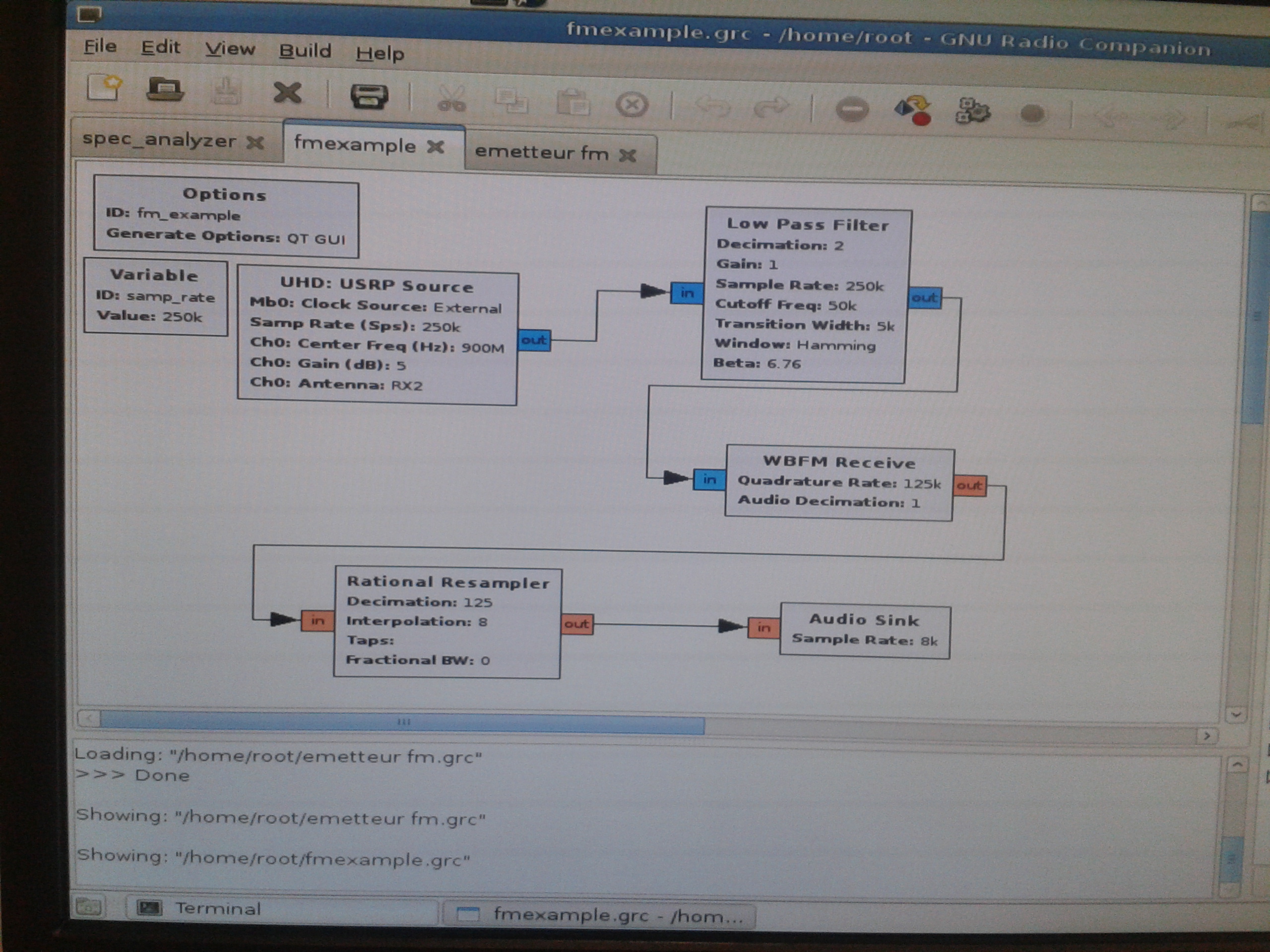

WE
Wafa Elhajhmida
Mon, Jun 16, 2014 9:18 AM
Thanks a lot for your reply.
In fact, in order to respect the band range frequency of the SBX
daughterboard Rev 5.1.
I sent an FM signal from a signal generator called NI PXIe-5673 described
in this link:
http://sine.ni.com/nips/cds/view/p/lang/en/nid/205593. The signal that I
generated, it is a sinus and has 900 *MHz *frequency.
So that I created my proper FM station on 900 MHz  to respect  the band
range frequency allowed by SBX daughterboard Rev 5.1.
In order to receive the signal generated by usrp e110, I implemented an FM
receiver flow graph on usrp e110 which is attached below and I used an VERT900
Antenna, described in this link:
https://www.ettus.com/product/details/VERT900  .
But I still have noise generated by usrp e110.
Have you an idea if there is a non suitable parameter on the flow graph ?
Thanks in advance
Best regards,
Wafa HAJ HMIDA
