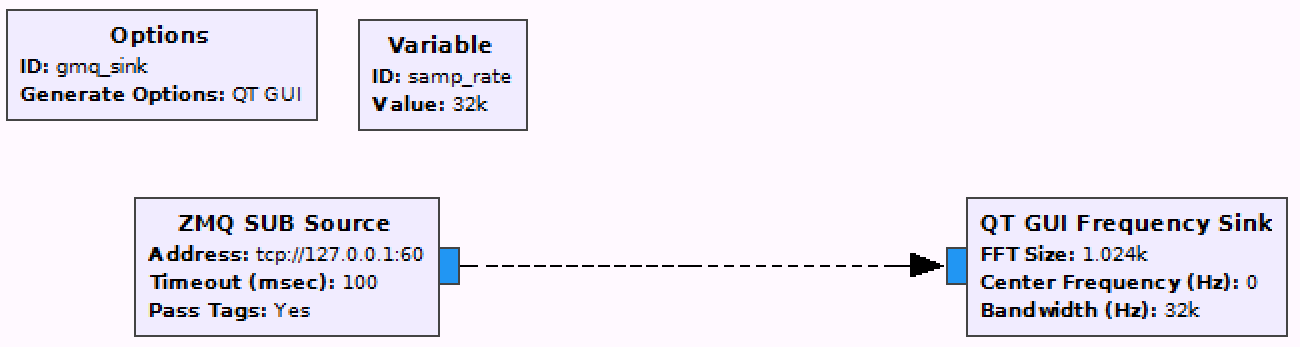

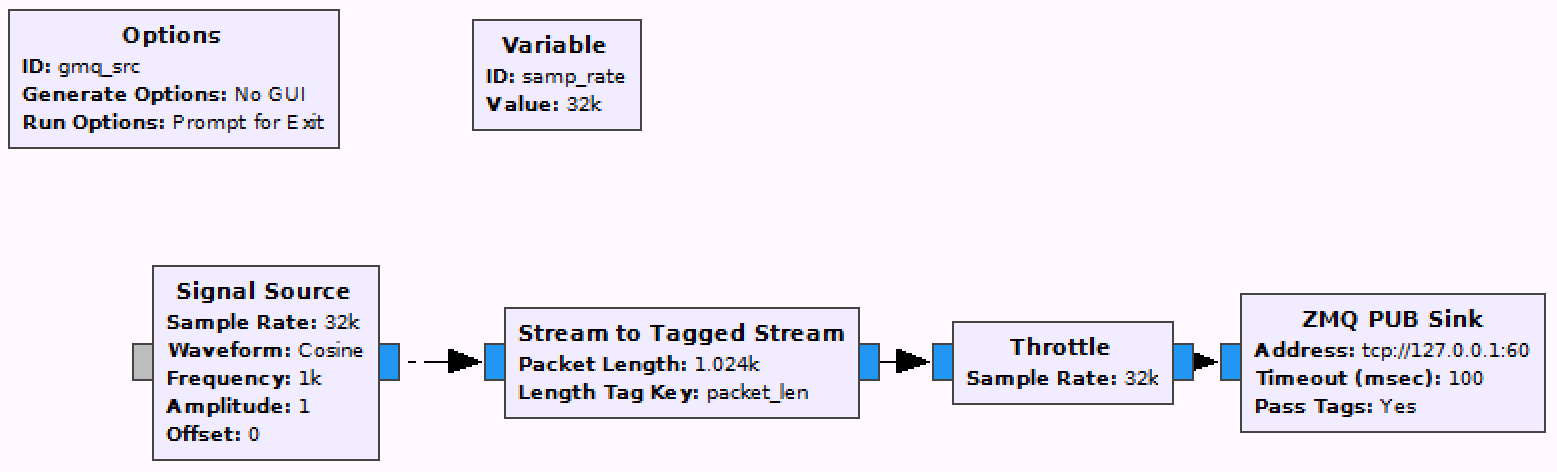

I'm testing ZMQ streaming with GRC and E310
It was succesful local loopback test with ZMQ_src and ZMQ_sink on
development computer
But when I python zmq_srcpy on E310 USRP , I got error
It's not easy for me to understand what this message mean

Hi Kim,
In the generated Python file "gmq_src.py", you need to edit the line:
self.zeromq_pub_sink_0 = zeromq.pub_sink(gr.sizeof_gr_complex, 1, "tcp://127.0.0.1:60", 100, True, -1)
to be:
self.zeromq_pub_sink_0 = zeromq.pub_sink(gr.sizeof_gr_complex, 1, "tcp://127.0.0.1:60", 100, True)
Note the removal of the last parameter ", -1".
This is due to mismatch of GNU Radio version between your host where you generated the Python file and the version running on the E3xx.
