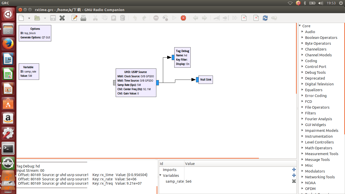

In the attachment, this is rxtime.grc.
We use it to display the time of tags of received signal, and this is USRP's time?
In result.png, there is
Offset: 0  Source: gr uhd usrp source1    Key: rx_time  Value: {0 0.956504}
We can not understand it, what is it?
If we want to get the time is 141757.00(UTC time or GPS time), how can we do?
As detailed as possible, thank you!

Offset : 0 indicates the first sample output by the USRP source
Key : “rx_time” is the tag key identifying it as a receive time tag
Value : {0, 0,956504} is the time value from the SDR associated with the USRP source. The time is 0.956504 seconds and is derived from the SDR’s internal clock.
You can either determine the host’s time and use rx_time as the initial offset (i.e., add the two together) and then count samples and calculate the sample time based on the sample rate.
Or you can set the SDR’s time. That will require either modifying the USRP source block code to accept a UHD set time command via the control port, syncing to the PC’s time, or creating a block that can access the USRP source block at runtime to set the time, or modifying the generated python for the flowgraph to set time. There are various emails on the list describing some of those approaches.
There is no (AFAIK) “easy” way to set the time to UTC or some other value.
