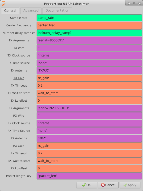

I am trying to use the USRP echotimer block from gr-radar module. But when I run the flowgraph containing this block, I get the following error:

My transmit device is USRP B210 and the receiver is USRP N210. The settings of the USRP Echotimer block are attached. What could be causing this error?
causing this error?
this error?
