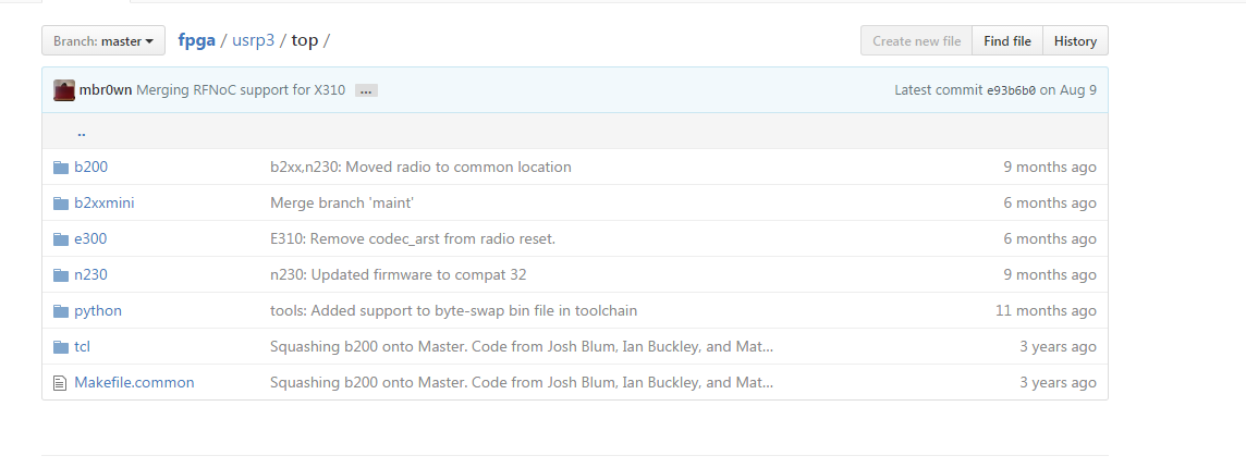

Hi Jonathon,
Thank you for the quick reply. I thought so too, but I cannot find the
directory usrp3/top/x300. This is all I see

Hey Nives,
You need to look in usrp3_rfnoc for the x300 code.
