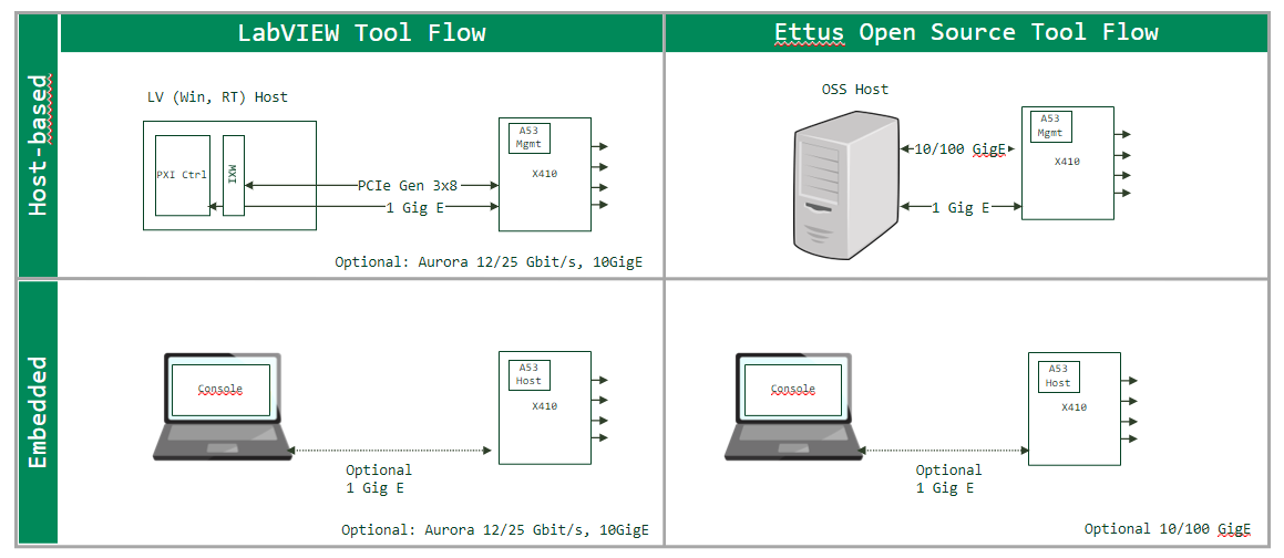

please check also the operation modes and supported tool flows below:
Another suggestion is to check the IP addresses provided in the above link.
