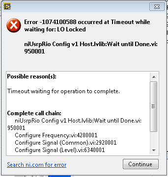

To add a bit more information I attach the error message that was
obtained for USRP RIO 2953R with UBX-160.

Hi Piotr,
LabView sees the the USRP RIO device as a single device inclusive of
motherboard and daughterboards, so changing the daughterboards makes it
unrecognizable to LabView.  This is done intentionally to limit the number
of configurations for things like calibration routines and other LabView
features.  UHD can recognize any combination of motherboard and
daughterboards, but it is a lower level driver and does not provide an
application feature set like LabView.

Michael, many thanks for the answer solving the problem. It will be much
easier to talk to NI support having this information. Even if they
refuse to make the conversion we can do it ourselves.
Best Regards,
Piotr Krysik
