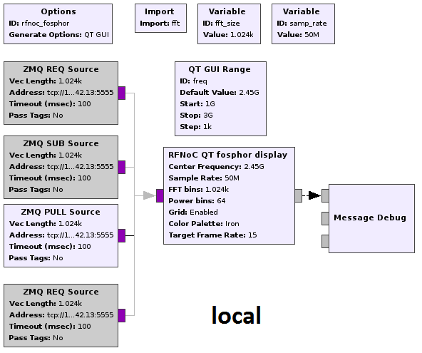

Hi Sylvain and thanks for the hint,
Now, I am back to work on demo-ing rfnoc-fosphor.
I have installed ZMQ as part of GNU Radio and then installed gr-zmqblocks as OOT. I have tried next to run examples as stated in gr-zmqblocks github repo. (client/server and gui app).
I am actually not sure what to expect.
However, I've tried the examples under share/gnuradio/examples/zeromq and they worked fine.
Now for the RFNOC fosphor, I ran the grc app on the remote (to which is connected the X310) where I connected the RFNOC FIFO to one of the ZMQ sinks and of course de-enabled the downstream blocks.
On my Laptop (local) I have installed UHD using rfnoc branch, GNU Radio and gr-ettus (all using pybombs),
then ran rfnoc grc app beginning by ZMQ source (each time I tried an equivalent to what I was using at the remote (REP-REQ for ex...))
First, whatever I tweak I am not getting any display on the local machine.
Second, I am getting a non-stop timeout on channel 0. I am actually getting those right away if I set sampling rate to 100MHz.
Is there another graceful way to dissociate the streaming commands from the X310 (after those underruns happens) so that I won't have to power-cycle the X310 each time that happens.
This would be of the a great help especially if the radios are not always reachable (teleworking).
