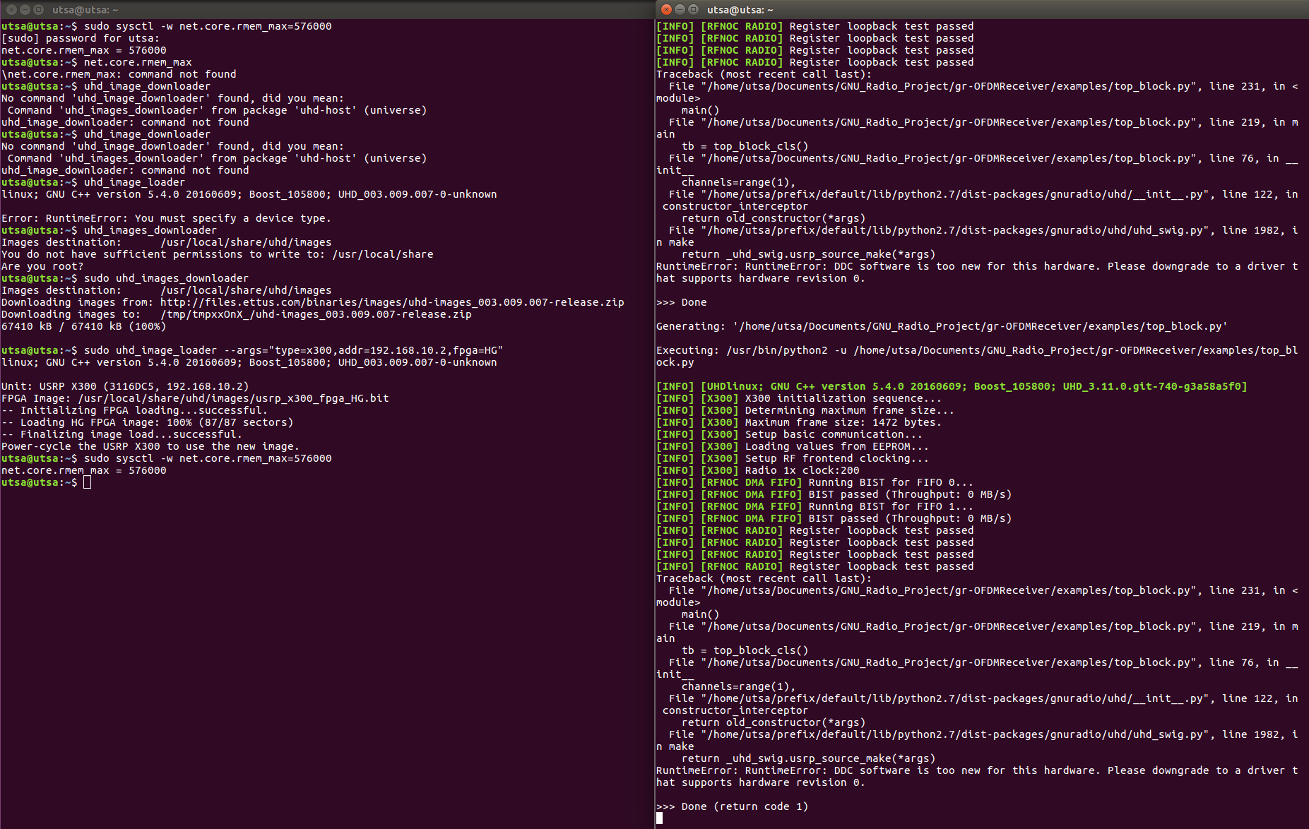

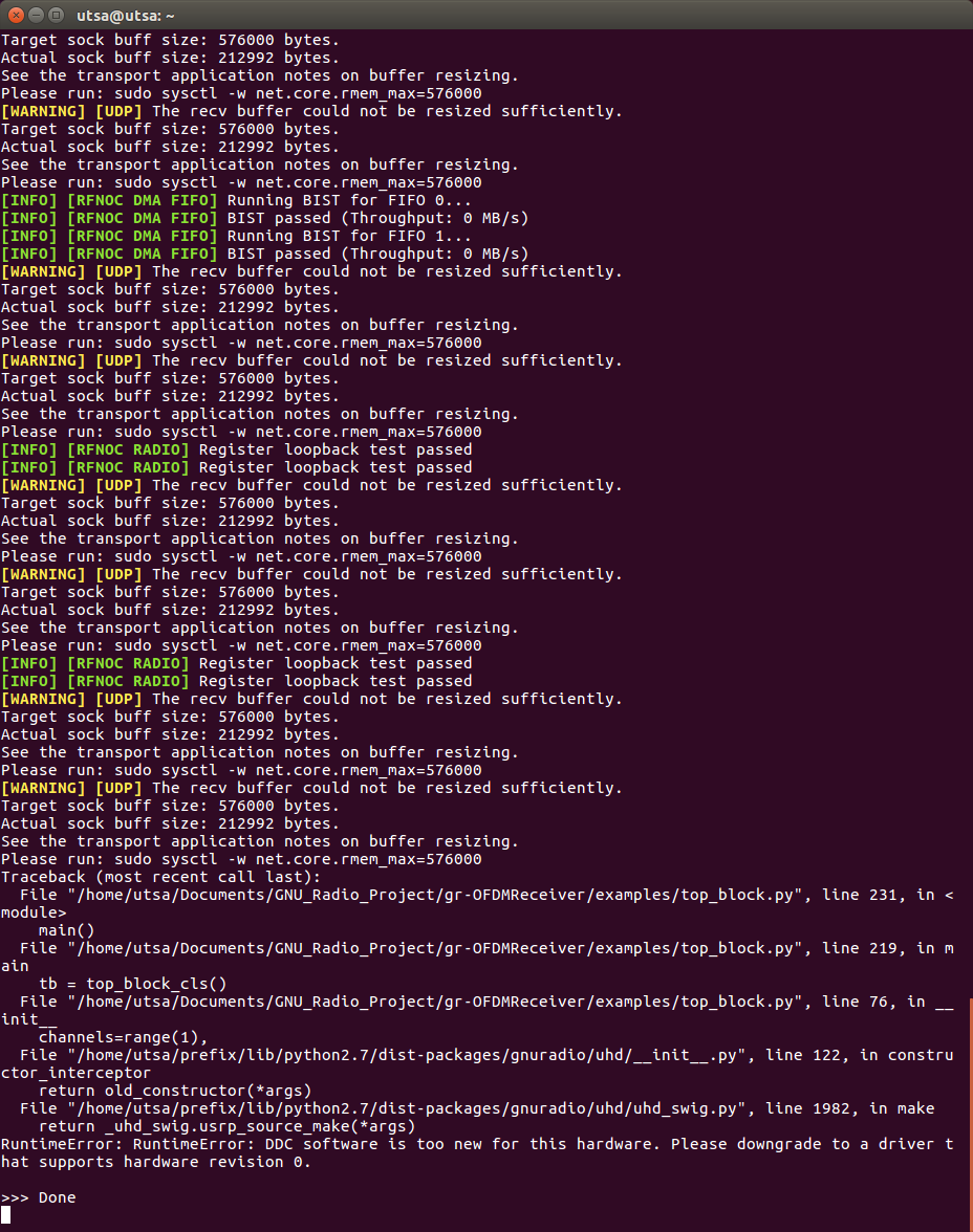

Hey guys,
I've used the uhd_images_downloader and the uhd_image_loader as per
Nicolas's suggestion and altered the buffer size to 576,000 as Jose
suggested. Neither of these attempts worked! The uhd_images_downloader
installed 003.009.007-r onto the USRP. Is there any other way to change the
DDC software or overcome this flag? See the attached image for the latest
diagnostic screen shot.
Thanks,
Taylor
