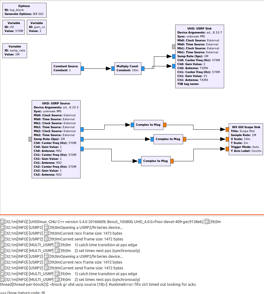

Hello all,
I have 4 USRP N210s synced with an octo-clock and connected to a host PC via a switch. I'm trying to use the multi-usrp blocks in GRC for the following setup:
-- TX using usrps with IP1 and IP2
-- RX using usrps with IP1, IP3, and IP4
All IPs are in the same subnet 192.168.10.X
I've attached the grc file and screenshot of the flowgraph.
I get the following output when trying to run the flowgraph (error in last line):
[INFO] [UHDlinux; GNU C++ version 5.4.0 20160609; Boost_105800; UHD_4.0.0.rfnoc-devel-409-gec9138eb]
[INFO] [USRP2] Opening a USRP2/N-Series device...
[INFO] [USRP2] Current recv frame size: 1472 bytes
[INFO] [USRP2] Current send frame size: 1472 bytes
[INFO] [MULTI_USRP]     1) catch time transition at pps edge
[INFO] [MULTI_USRP]     2) set times next pps (synchronously)
thread[thread-per-block[3]: <block gr uhd usrp source (18)>]: RuntimeError: fifo ctrl timed out looking for acks
The error shows up in the known issues page here: http://www.ni.com/product-documentation/53455/en/
With a workaround: Open an Rx and Tx session to the same list of devices. You can disable the unused channel in the session where you added it.
However, it is not clear to me how this can be done in GRC using the multi-usrp block. How does the "device arguments" field change? How do I "disable" unwanted/unused channels?
Is there a fix for this issue or just the workaround?

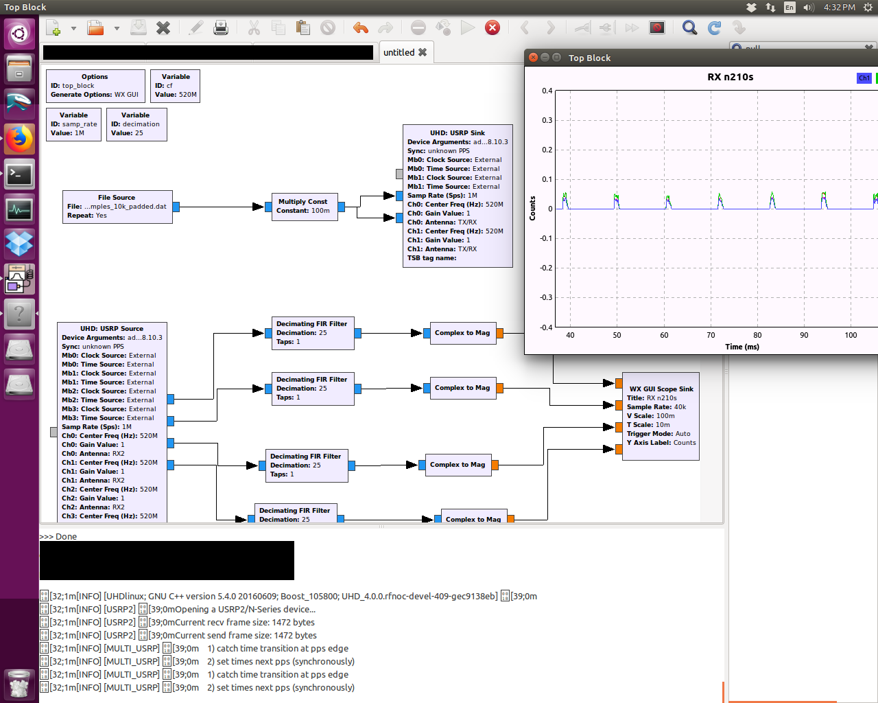

Never mind. Fixed it after reading this post: http://lists.ettus.com/pipermail/usrp-users_lists.ettus.com/2017-January/023347.html
TLDR: Increase read/write socket buffer sizes. Something like this:
sudo sysctl -w net.core.rmem_max=50000000
sudo sysctl -w net.core.wmem_max=50000000
And then making the device addresses the same and "consistent".
The multi usrp source and sink blocks take the exact same string for the device arguments field. In my case:
device args: "addr0=192.168.10.7,addr1=192.168.10.4,addr2=192.168.10.2,addr3=192.168.10.3"
I use usrps with last octet 7 and 4 to TX via the multi usrp sink block. I set the number of channels to 2 in that block, and therefore the first 2 IPs from the device args are used for TX-ing.
I use ALL usrps to RX via the multi usrp source block. I set the number of channels to 4 in that block, and therefore all the IPs from the device args are used for RX-ing.
This works out for my setup, but I don't know who it works for more complex setups.
Screenshot and grc file attached.
