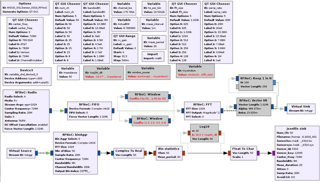

My flowgraph is as the following:
[cid:image002.jpg@01D23067.412DEFE0]
How to debug and find out what is causing overflows ?
