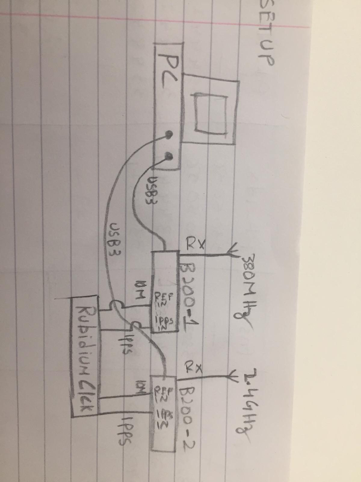

Hi,
Hope you're doing well. I am new here and new to the USRP API. Attached
is a setup to record signals at 380MHz and 2.4Ghz on two B200's. The aim
is to sync the devices using the 10Mhz and 1PPS provided from an
external source to both devices.
Using the python API to achieve this and here is a snippet used to test
multiple-usrp

Clearly the second device is not registered by the MultiUSRP method. I
found the C++ equivalent to this for the x series devices on the usrp
manual; which is:

Have these methods been exposed to the python API? If yes, a quick
example would be helpful.

Hi,
Attached is a setup to record signals at 380MHz and 2.4Ghz with two
B200's. The aim is to sync the devices using the 10Mhz and 1PPS provided
from an external source to both devices.
Looking on pointers on how to sync the two devices (meaning trigger the
data recording on both devices at the same time). Which API functions
would enable us to achieve this as closely as possible?
Thanks.

There is a restriction that you can only have a single B2xx device in a
multi_usrp object, so, you'll need two objects.
So, create two multi_usrp objects--one for each device.
Use a wait loop on ONE of those devices for the get_time_last_pps() to
change, and THEN use set_time_next_pps() on BOTH devices
to reset the clock to the same value.
Then use timed streaming on both devices to cause streaming to start at
some time in the not-too-distant future.
