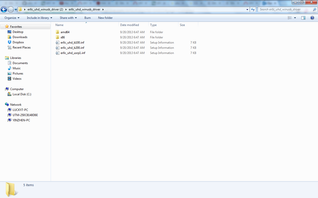

2) Inappropriate driver(Refer to Attachment Picture Driver From Ettus.jpg)
- Driver Link Source: http://files.ettus.com/binaries/misc/erllc_uhd_winusb_driver.zip
- Supported Device in the zip package doesn't include E110

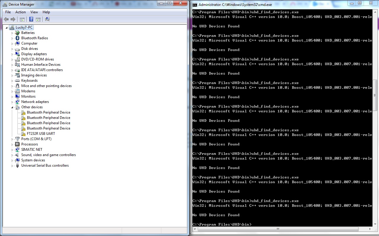

Summary: What I was trying to do is just to run a simple example software that come from the UHD folder after the driver installation(e.g. tx_waveforms.exe).  However, it won't run because my computer can't detect the USRP device. I connect the USB console to my PC and run uhd_find_devices.exe file which show that my PC does not detect the device.

Hi Chun,
The E110 series is an embedded platform and not accessible
from your computer via the UHD driver. You will need to use the CONSOLE
connection with a USB cable to access the embedded Linux platform. You copy
your GNU/Radio applications from your computer and run it on the E110.

As a matter of fact, everything is already pre-installed in  the E100/E110.
Not the latest version though.
I suggest to become  familiar with the way it works before trying to update
anything.
A serial port connection, an SSH connection or connecting the E110 directly
to a display and keyboard will work.
