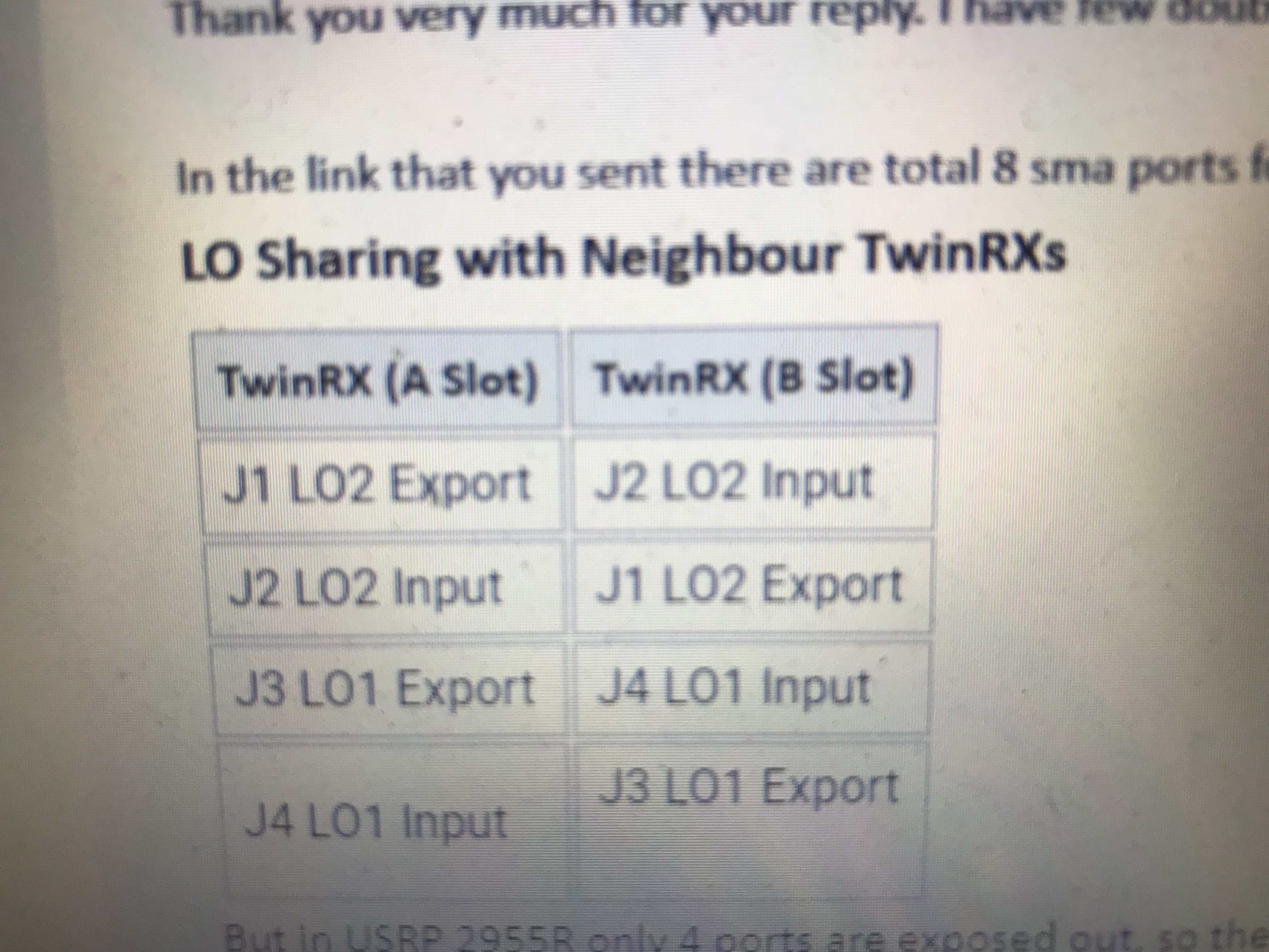

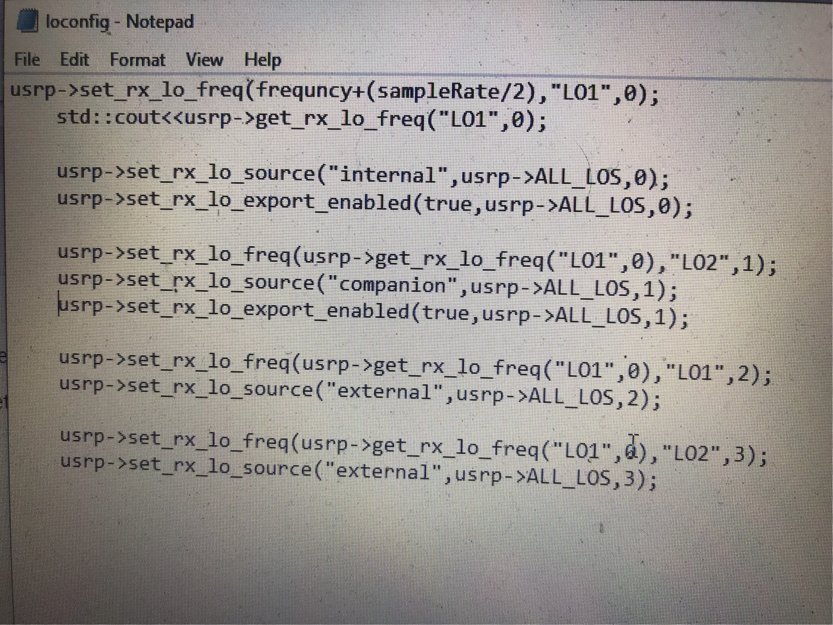

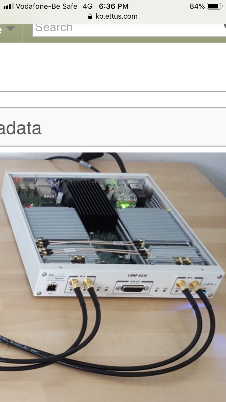

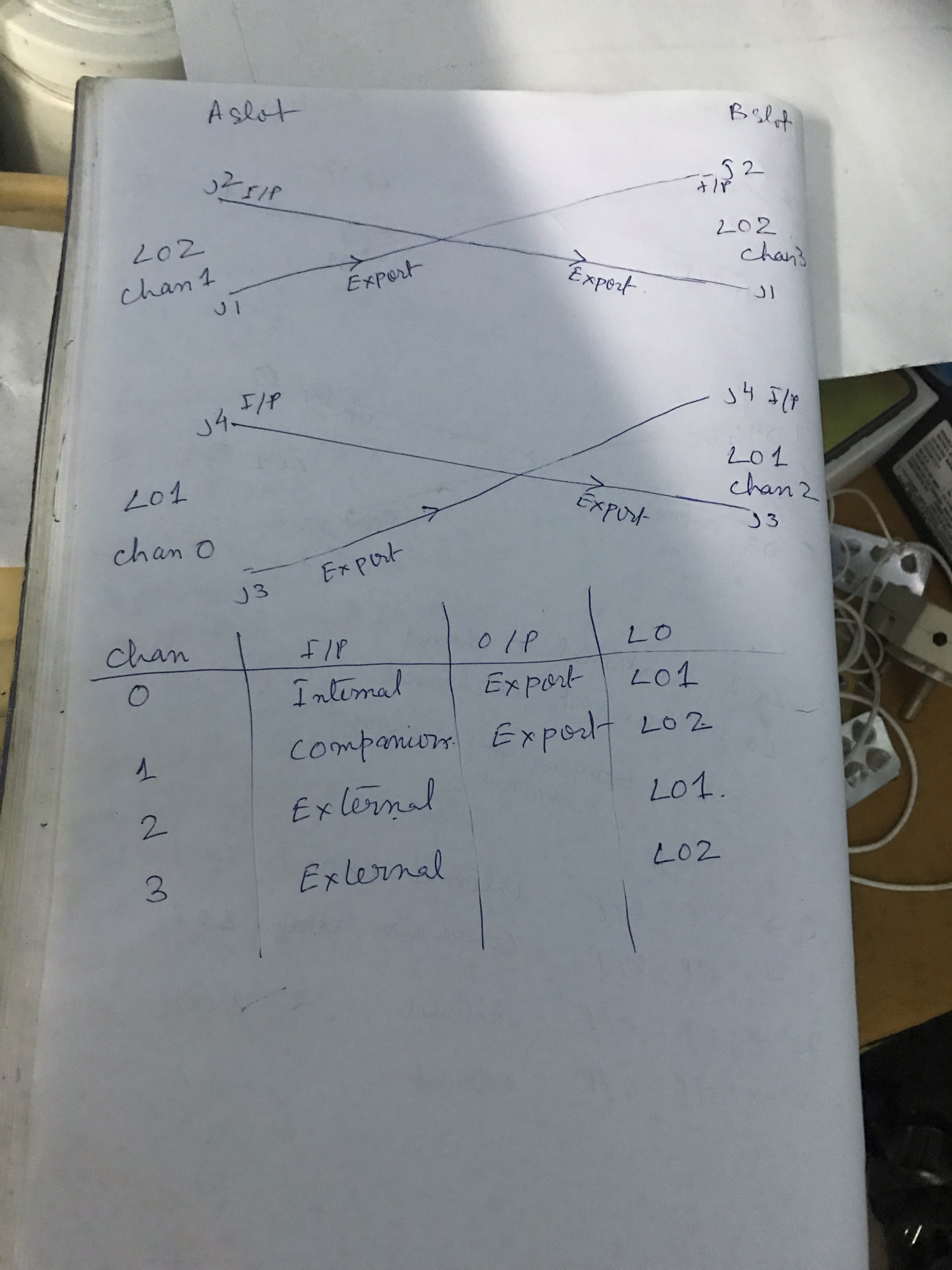

Hi,
I have come up with the attached commands for LO sharing in gr-ettus. I am attaching all materials on how I arrived to that. Please see these if correct. I may be wrong somewhere then please correct me[Image.jpeg][Image.jpeg][Image.jpeg][Image.jpeg]

This looks correct.
Please next time take proper screen captures and attach actual file snippets instead of using your camera.
