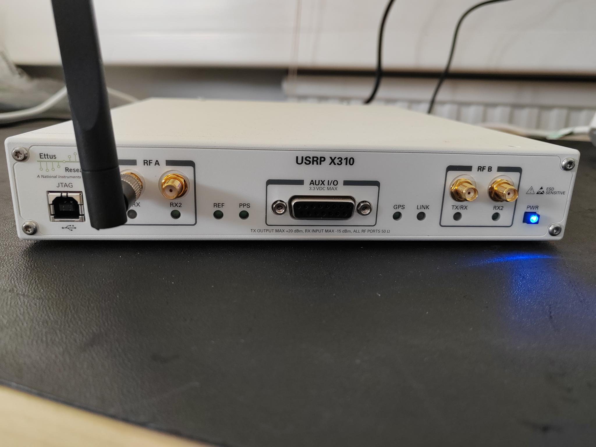

Dear all,
I need to your help.
Today, my machine does not detect my X310 USRP anymore.
Fan spins.
All LEDs are off except the power (Attached photo)
Ethernt LEDs are off.
Thank you in advance.
Regards,
Ali
Dear all, I need to your help. Today, my machine does not detect my X310 USRP anymore. Fan spins. All LEDs are off except the power (Attached photo) Ethernt LEDs are off. Thank you in advance. Regards, Ali
WF
Wade Fife
Tue, Feb 21, 2023 3:42 AM
Hi Ali,
I wonder if the FPGA is not coming up. I'm not sure what the LEDs do in
that case and I don't have a device handy to check. You could try this
recovery procedure to see if that fixes the problem.
https://kb.ettus.com/X300/X310_Device_Recovery
If not, the device may be damaged.
Wade

AM
ali.mahbas@brunel.ac.uk
Tue, Feb 21, 2023 9:51 AM
Hi Wade,
Thank you for your response.
This one has been suggested by the ETTUS support. Luckily it helped to solve the issue. Thank you though.
Out of interest and for the future reference (as we have a number of USRPs), what would the options be if a device is damaged?
Kind regards,
Ali
