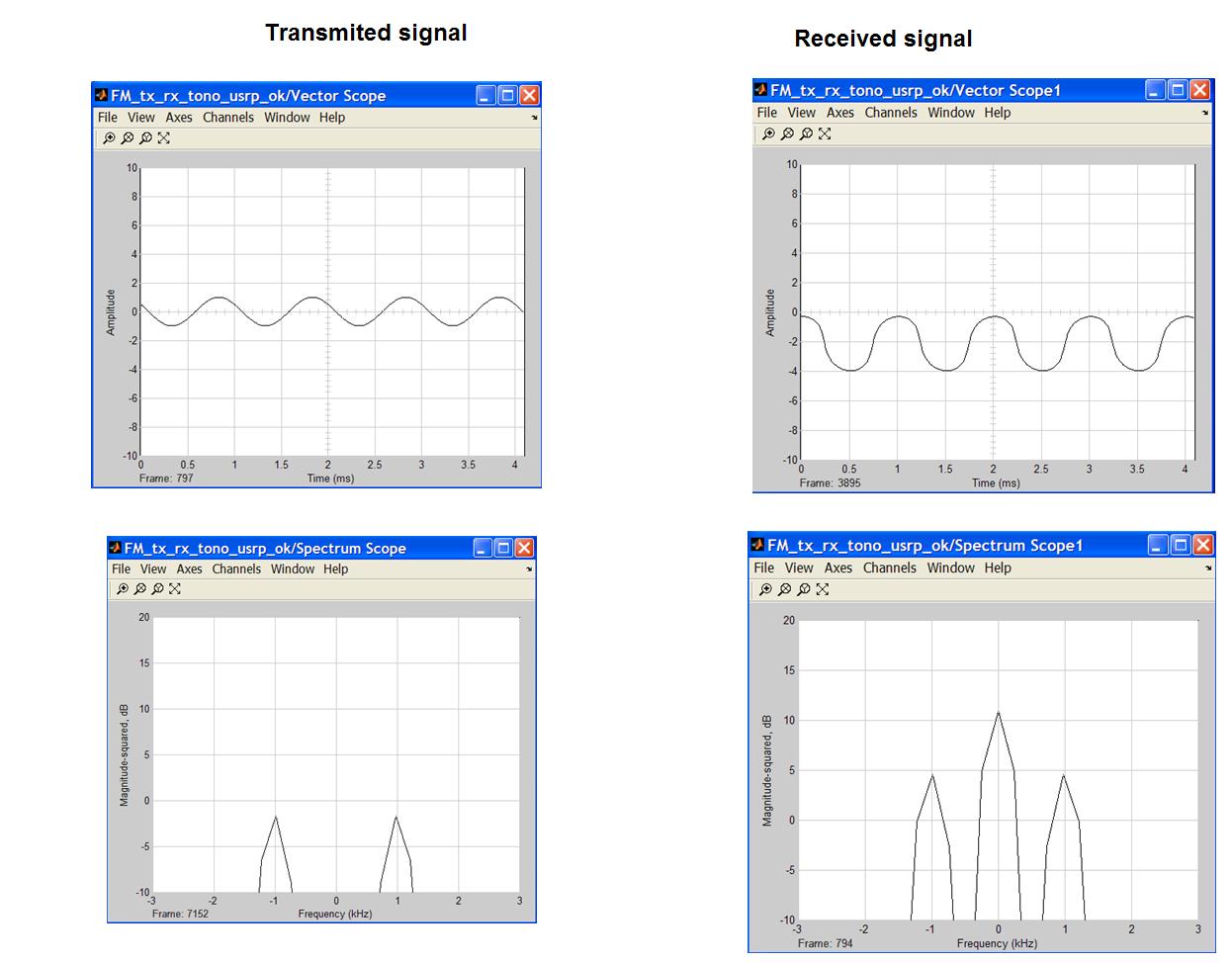

Hi, I need some help.
I’m new using usrp (I have the usrp1 module and 2 wbx daughters boards
installed in simulink with kit cel,  http://www.cel.kit.edu/usrp.php), and I
want to send a message m(t) (1khz  1v simple cosine tone) using phase
modulation and receive the massage in the same usrp module (side as tx, side
b as receive, connected with a sma cable); I have this model in simulink:
Tx:
Cosine signal source m(t)--> exp(u) block-->2^14 gain block-->usrp_sink
Rx:
Usrp_source-->complex to angle block-->unwrap block
I’m based on Euler’s law:    exp(phi)=cos(phi)+jsin(phi) where exp(phi) is
baseband equivalent of carrier with variation phase. I supposed that usrp
module multiplies  exp(phi) by exp(2pifct )  generating
exp(2
pifct+phi) and sending it. In the receiver the usrp module
multiplies by exp(-2pifc*t+phi) and I got only exp(phi), after with
complex to angle block and unwrap block I obtain phi(the original cosine
tone).
All is practically working  but there is some problem: the received signal
has a DC offset level with variations and some low level spurious signals,
the question is how can I improve it to obtain the original signal.
Images of transmitted and received signals are attached.
